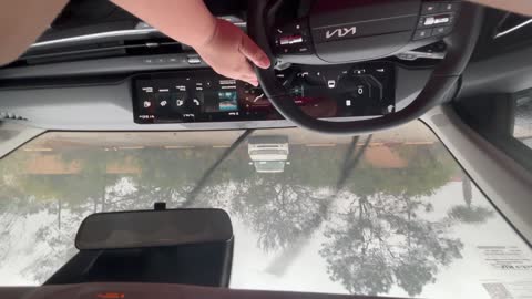

Weather is cold and chilly today in the 50s and rain was pretty light no crazy torrential downpour and I noticed a judder with my wipers. Is this normal? Just recently had a multipoint inspection at kia a few weeks ago and they checked everything. We have had an influx in cold frosty weather would that affect the wipers and make them judder? Seems like the left one is the one dragging more

Yep, one of the wiper arms got bent in the storm, please watch this video it will show you how to fix it.
https://www.youtube.com/watch?v=w0I-obFmADE&pp=0gcJCZEKAYcqIYzv
Please go over this guide and get back to us. Thanks for the video it helps.

I noticed if I pour a bunch of water on the windshield and run them it doesn’t do that noise but during light to medium rain on int speed it makes that noise. How can you tell is bent?

Update I went to a local mechanic and he took off the driver side blade and inspected it he said the rubber was intact it was just slightly floppy but still was in good condition and said it wasn't bent and that it could just be from the cold plus the flopping, does that sound accurate? If the mechanic looked at both blades wouldn't he be able to see if it was bent?

Arm isn’t bent I had blades inspected at mechanic. Noticed after I cleaned thoroughly with auto glass cleaner that dragging noise disappeared
