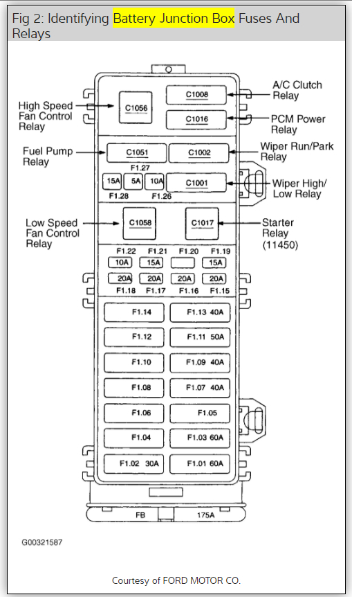

Installed a stereo in this car and windows work off and on and no windshield wipers at all.

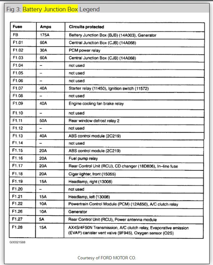

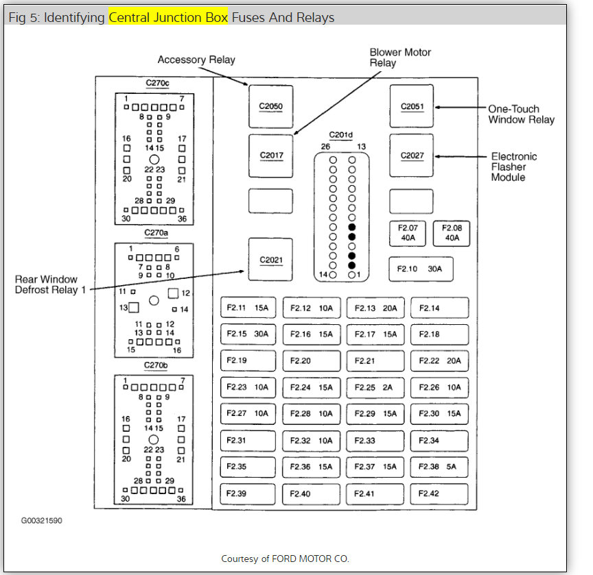

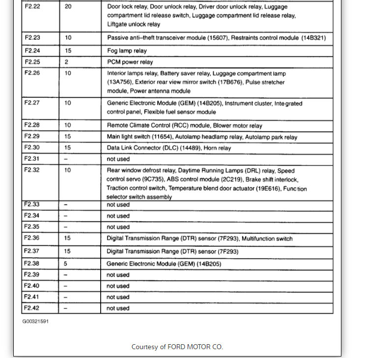

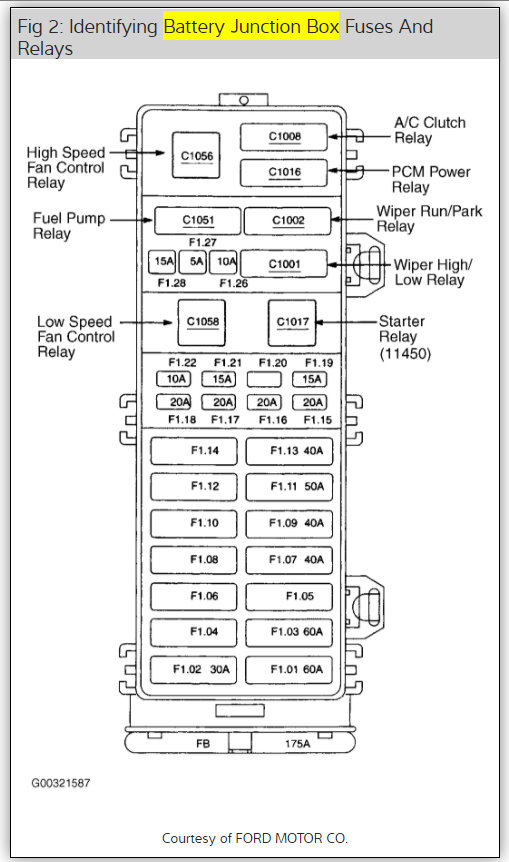

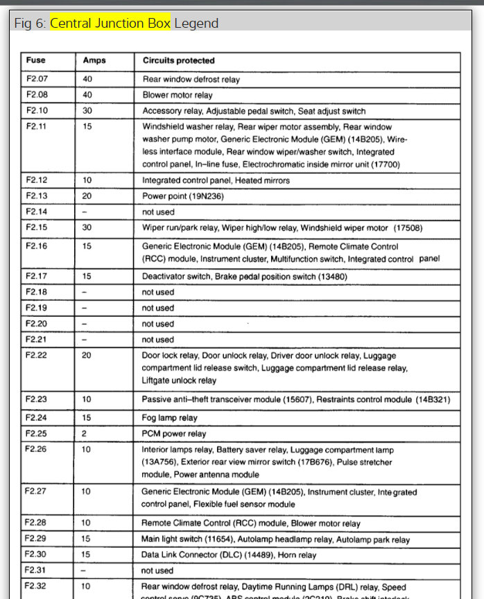

It sounds like you popped a fuse. To be sure here is a guide and the fuse locations in the diagrams below:
Check out the diagrams (below). Please run this test and get back to us.
