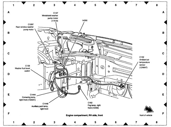

Front washer not working but back washer is?
Sunday, March 17th, 2019 AT 9:54 AM
KEN L
MASTER CERTIFIED MECHANIC
55,440 POSTS
It sounds like the front washer motor went out which is common. here is a guide to help walk you through the steps and diagrams below to show you how on your car:
https://www.2carpros.com/articles/how-to-replace-a-windshield-washer-pump
