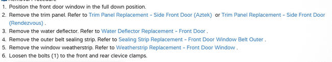

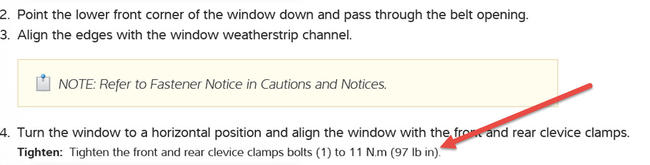

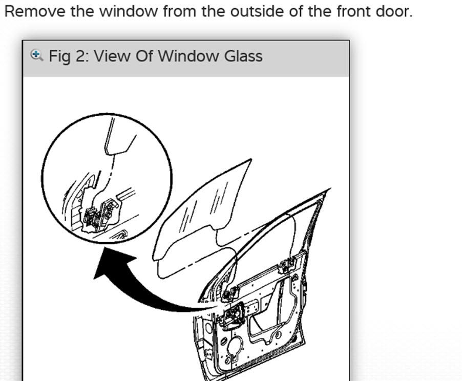

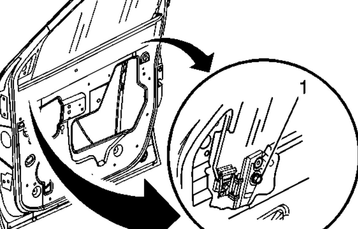

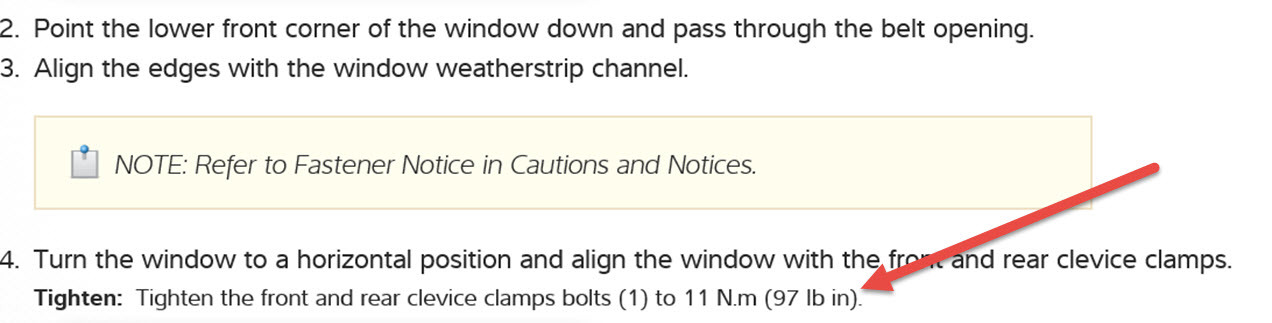

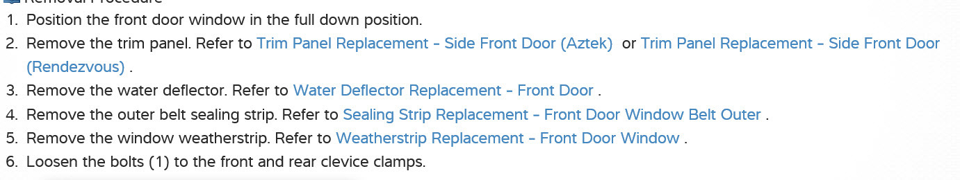

Do you have a diagram/instructions to replace the window glass?
Monday, October 12th, 2015 AT 11:38 AM
10 Replies
HMAC300
MECHANIC
48,601 POSTS
See pics
