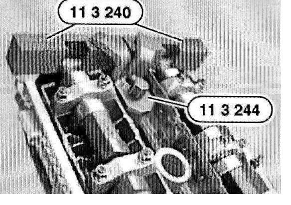

I rebuilt the double vanos unit. Before I removed it, I set number one at TDC. I did not use the special timing jig, simply lined it up the best I could visually (i.E. Both cams with rear square bolts facing up and both cam lobes facing each other, as close as I could get by eye).
I installed the rebuilt vanos unit and put in the left hand threaded bolts on both cams hand tight, then proceeded to torque the bolts. I started with the intake first (the one on the right) as I was torquing the bolt the vanos chain and sprockets turned to the left. I heard one audible click as it turned and saw the chain move. The camshafts did not move and the crankshaft also did not move only the vanos cones and pistons inside the vanos and the vanos chain and gears turned on the camshafts.
First question: Will this cause any issues with the timing of the engine (possible bent valve/piston damage) or affect the range of adjustments available to the computer for the vanos timing?
Second Question: If I need to fix this issue how do I do it and do I need the timing jig to lock the camshafts and flywheel to do this properly?
Any help would be appreciated.

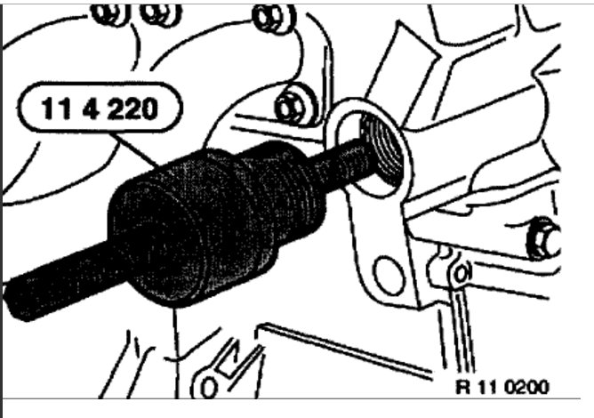

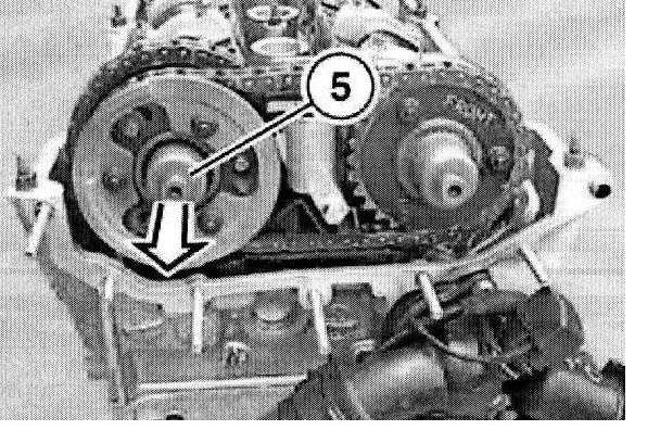

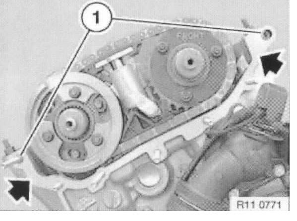

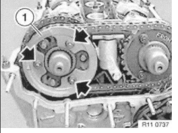

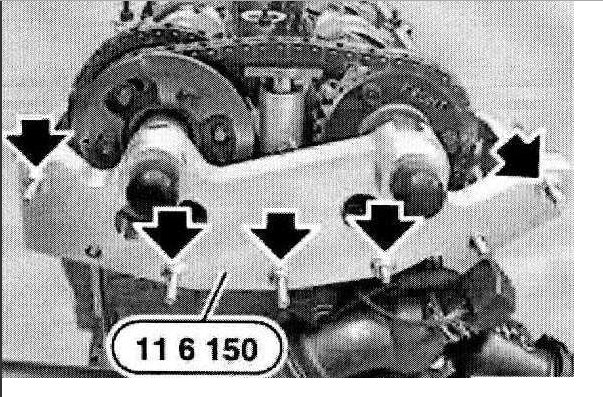

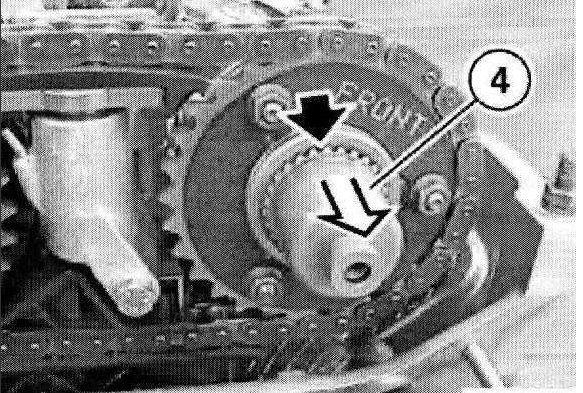

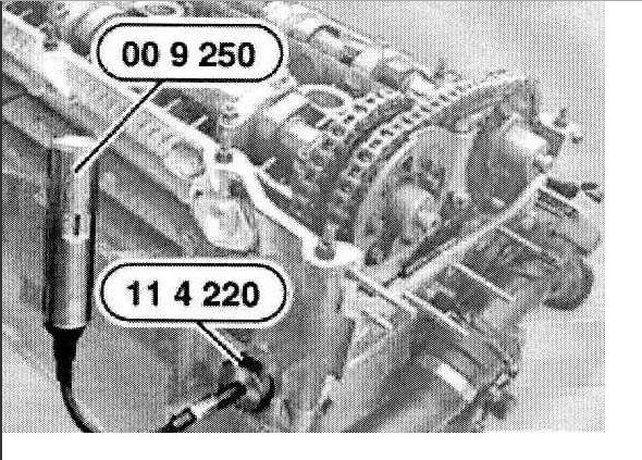

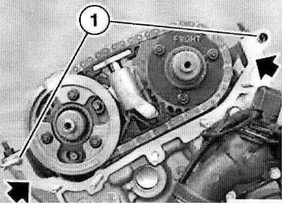

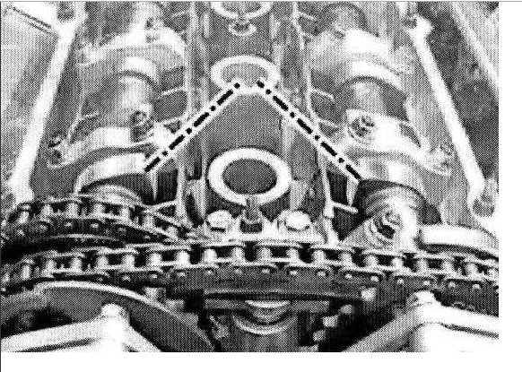

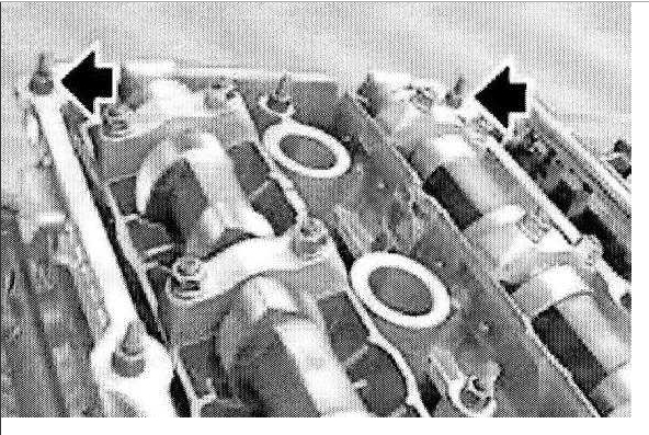

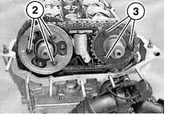

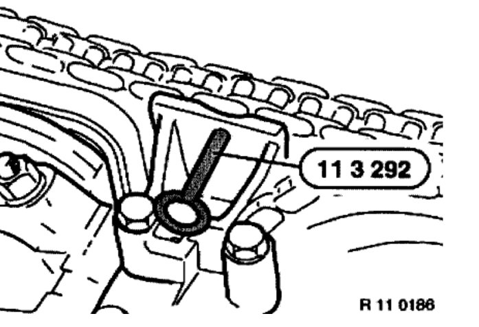

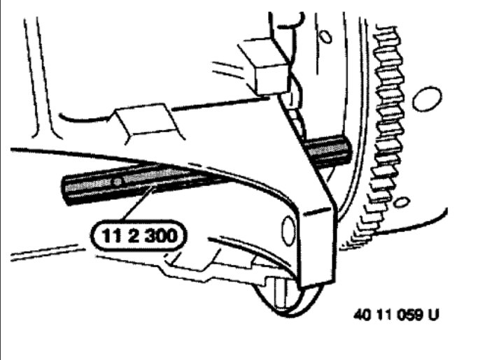

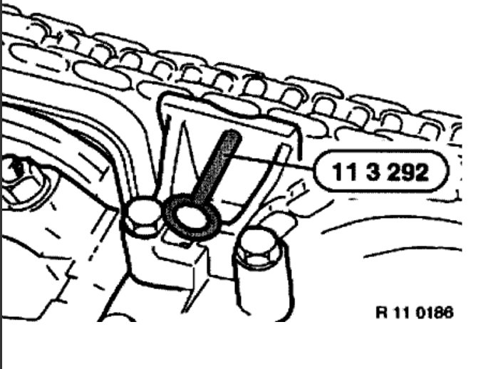

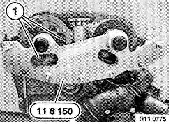

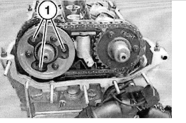

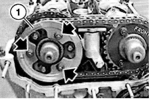

We did the exact same thing about a month ago on a similar car. It is tough to get the timing marks right if you do not use the tools. The idea is to have the vanos all the way retracted when lining up the camshaft flats and crankshaft pin. Below are some diagrams that should help.
You can do it with the tools if the crank is pinned and you have the vanos bottomed out with the camshaft flats in the right place. Double check all so you do no need to take it apart again like we did. ;)

Thanks for the reply, and the images. I have done quite a bit DIY on many cars, but this is my first BMW so I am learning as I go. I am assuming that I must use the timing kit to resolve this issue? Correct me if I am wrong, if I use the kit, lock the cams in position on #1 TDC and pin the fly wheel the engine timing and crank timing should be right on, since the only thing that was disturbed was the secondary chain and sprocket, is that correct?
To me that would mean I only really need to reset the vanos hubs and chain to their original position, is that correct? Would it then be possible to simply turn the secondary chain/gears etc, backwards to its correct position or do I need to redo the entire secondary chain, sprocket adjustments to get them in the right place.
Additionally, when all is lined up correctly the hubs of the vanos are both pulled out from their respective gears and equal amount, (i.E both parallel to each other using the vanos alignment jig to accomplish this). Then remove the vanos jig and install the vanos (carefully this time!).
This make sense or am I missing something?

When you had to do this, did you do the entire timing process from scratch for the engine then the vanos or did you only lock the cams and crank at #1TDC and only do the vanos timing? Also images show tool 113-2-44, I have not seen this tool available in any of the timing kits online. Did you have one or not use one, if so where was it available from?

Yes, you have the right idea as far as the position of the camshafts I did mine starting at #1 TDC using the pin in the crankshaft. The tool they show is strange the ones on the internet are a newer design and work better. If you are unsure of the timing of the vanos etc I suggest getting the tool even though the first time we did the job we eyeballed it and was fine. Please shoot a couple pictures of anything you have question about I have done this job many times.

I got mine from eBay as well shop around because I found the kit for $450.00 down to $120.00 so keep your eye out. I cannot remember the seller but the kit should work or you may need small modification. All you need to remember is the crank pin at TDC and the flats on the camshafts with the vanos bottomed out (not advanced).

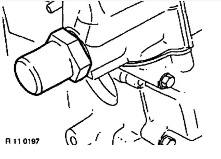

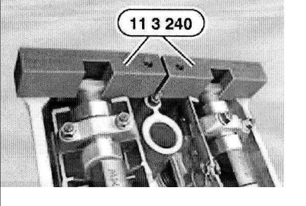

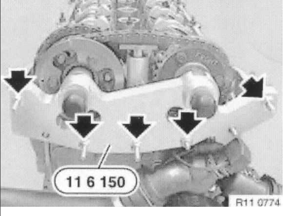

Once I get at it, I will take and upload images as I go. Is it possible to insert the crank lock pin without removing the starter? Book says its easier with its removed, I am debating whether it is easier to remove it from the bottom or remove the intake manifold to get at the starter from the top. Just in case I cannot get the pin in with the starter in place, which method would be easier?
Looking at the images of the cam locking plates in position, it appears they will not go on properly unless the intake manifold has been removed, am I correct in assuming it has to be off to install the tool? If it does need to come off, then the starter removal procedure becomes obvious.

I think you can install the pin without removing the starter last time I checked.

The timing chain guides are plastic and break often causing the timing to be off. The easier way to see what's going on is to remove the valve cover and line everything up. If everything is correct the vanos or control valve is not working. Check out the diagrams above to confirm the marks.
