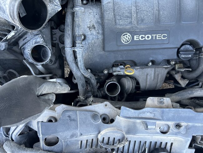

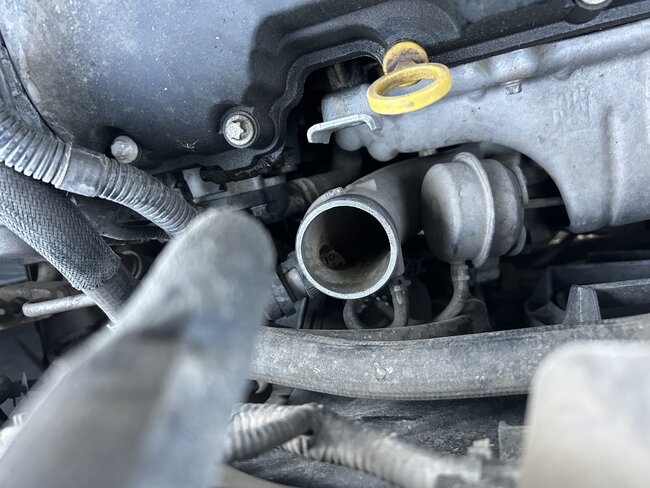

Hey Ken, I was able to pinpoint the problem. It was a stupid plastic piece (after the MAF sensor going to the intake) that broke. I repaired it, and the car fired right up and idled just fine.

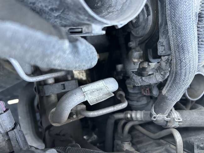

My next issue is the coolant leak. I mentioned that it was low, and as I poured coolant in it it just leaked out of the engine. I will attach some pictures of where it is leaking out. Can you send some information about what you think it might be? And the procedure to repair it. Again, many thanks for your help.

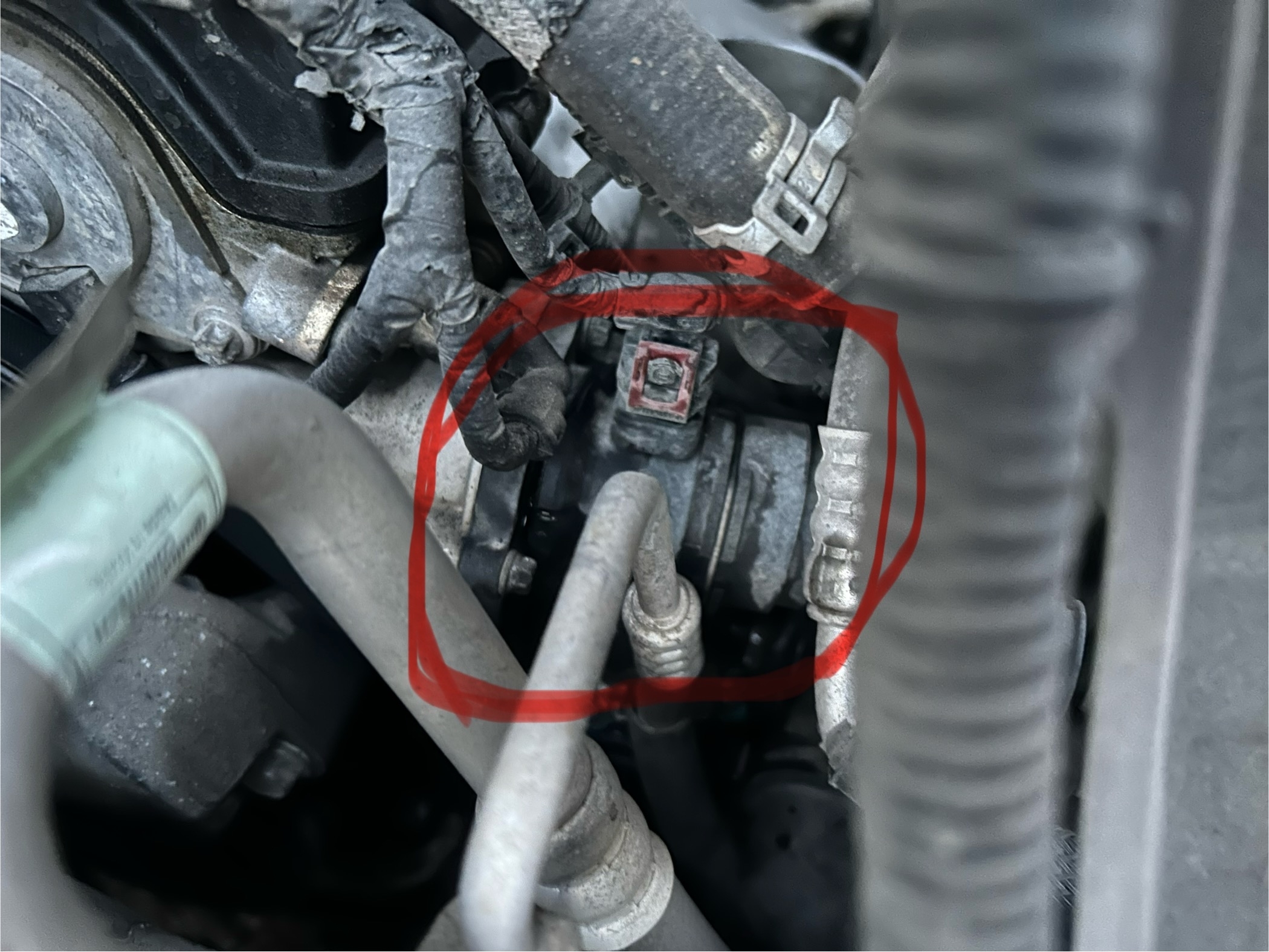

Hey Ken, I pulled off the front clip and I was able to get in there better and find out where the coolant leak is. I have attached a photo. It is this black piece that cracked. What is this piece that I need to replace?
