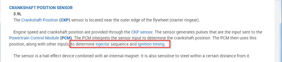

Clearly if this just happened after the transmission replacement, we need to go back over most of the connections, especially those of the PCM.
Also, we need to check the crank shaft position sensor as this is what the PCM uses for ignition and fuel system timing.
Let's start with these and go from there. Thanks

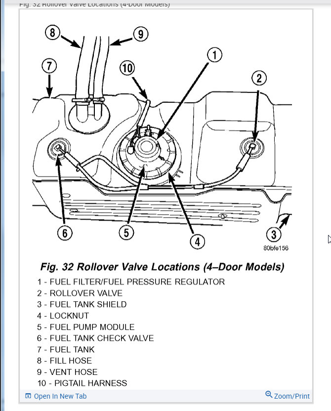

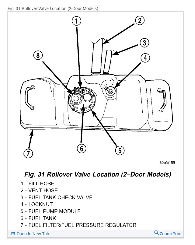

Reset transmission. Finally started and then cut off. Cannot find inertia switch/fuel cut off to reset?
Sunday, August 23rd, 2020 AT 10:18 AM
These trucks do not have shut off switches like Ford's do. They have a rollover valve in the fuel tank that will cut the fuel off.
Can you give a little more detail about how and why you reset the transmission? That may help a little bit with what happened. Before you said it was replaced so if it was just reset then we just need to dig into that a little more.
Thanks
Sunday, August 23rd, 2020 AT 6:51 PM

Problem solved: crank sensor. Wire damage. Beneath insulation.
Tuesday, April 27th, 2021 AT 6:19 AM
Awesome. Thanks for coming back and providing that information. That will surely help others as that is commonly overlooked. Thanks for using 2CarPros.
