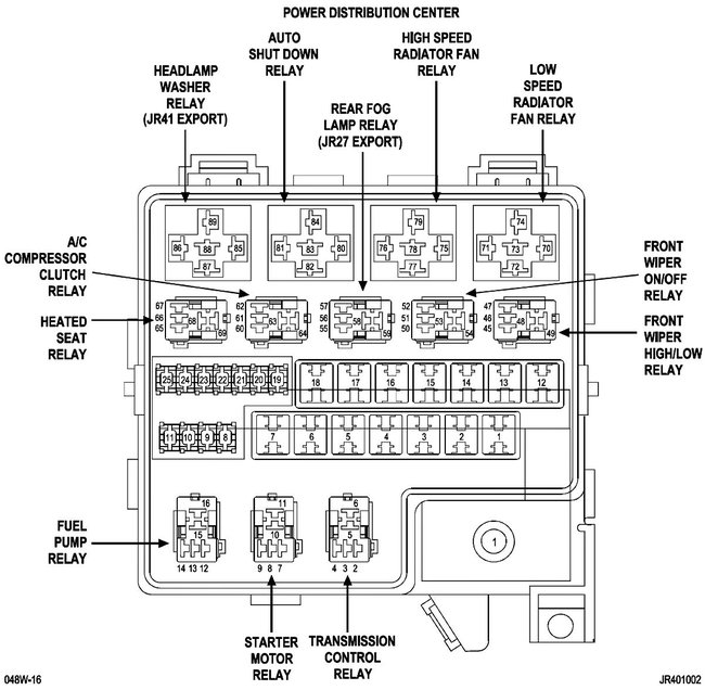

Where is the starter relay located?
Monday, January 7th, 2019 AT 5:57 AM
  • 110,192 POSTS
The Starter Relay is located in the Power Distribution Center (PDC). The Power Distribution Center (PDC) is located in the left front corner of the engine compartment, just behind the battery.
I attached a picture of the location to help find it.
If the starter isn't working, take a look through this link and let me know if it helps.
Let me know what you find or if you need additional information
