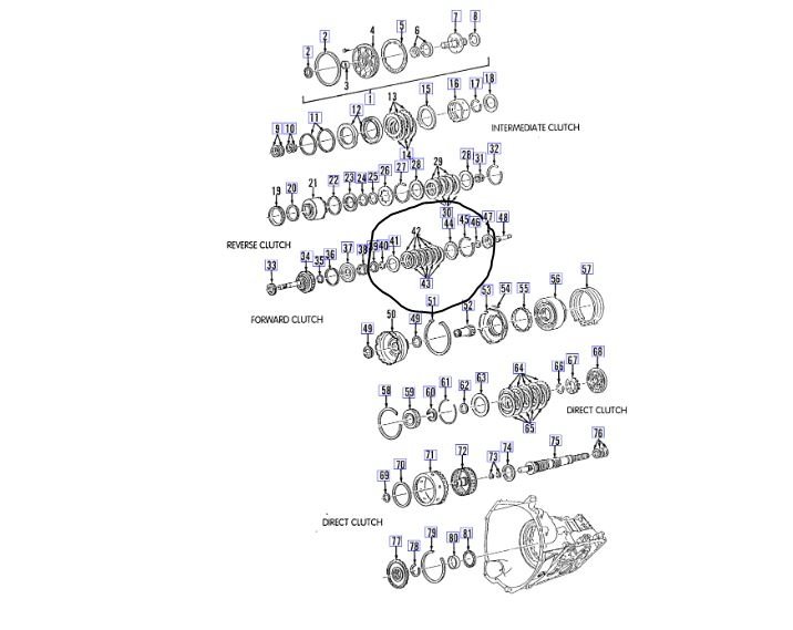

My car rpm not moving, and it not going when put in drive but it revese.
Sunday, June 23rd, 2019 AT 8:23 AM
3 Replies
Good afternoon,
If it goes into reverse, then either the forward clutch pack has failed or the sprag inside the transmission.
The transmission will have to be removed and inspected for the failure.
Sunday, June 23rd, 2019 AT 10:45 AM
DRUCILLA
The check engine light is not on. I have an airbag light on and it feels like it wants to but it like it not getting pressure to go and my throttle cable is looser.
Sunday, June 23rd, 2019 AT 11:12 AM
No, sorry. This issue is internal in the transmission.
