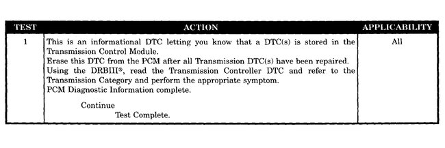

A P0700 is a generic code that indicates there is a diagnostic trouble code stored in the transmission control module. Since you replaced that, we can't read what was actually wrong. (See pic 1) By any chance, were there other codes stored that you remember? Also, this vehicle uses the Power-train Control Module (PCM) instead of the Transmission Control Module (TCM). Is that what you replaced?

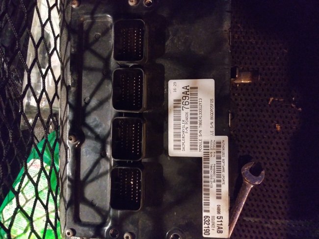

Thank you for responding. Attached is a photo of what they told me was the TCM. Also there were 2 additional codes. I don't remember the numbers but they were for the input and output speed sensors which I already replaced. Also, the speedometer is going crazy and not registering. Or do I simply replace the whole transmission?

If the transmission was working properly (not slipping or any other issues) prior to going into limp mode, chances are it is okay. This leads me to believe it is related to an electrical component. My concern is if I suggest replacing the PCM (which is what you have in the pic), it could not change the issue. When it was scanned originally, there should have been specific transmission codes. When it was scanned, was the tool used able to read transmission codes?

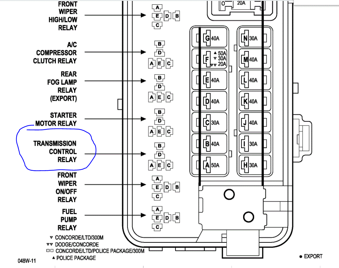

Just for the heck of it, switch the transmission control relay with a different one in the power distribution box. Just make sure they have the same part number.
Also, keep in mind that the PCM is constantly monitoring the transmission. When it recognizes a problem, electrical power is taken away from the Transmission via the PCM, de-energizing the transmission control relay, and taking power from the solenoid pack. When this happens, the only transmission mechanical functions are park/neutral, reverse, and second gear. That's why I'm suggesting that you check the relay. I attached a pic below of it's location in the under hood power distribution box.
