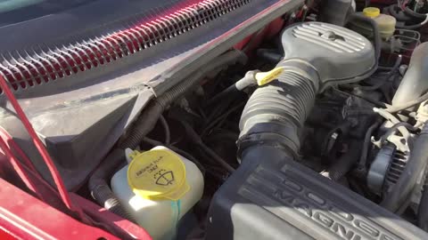

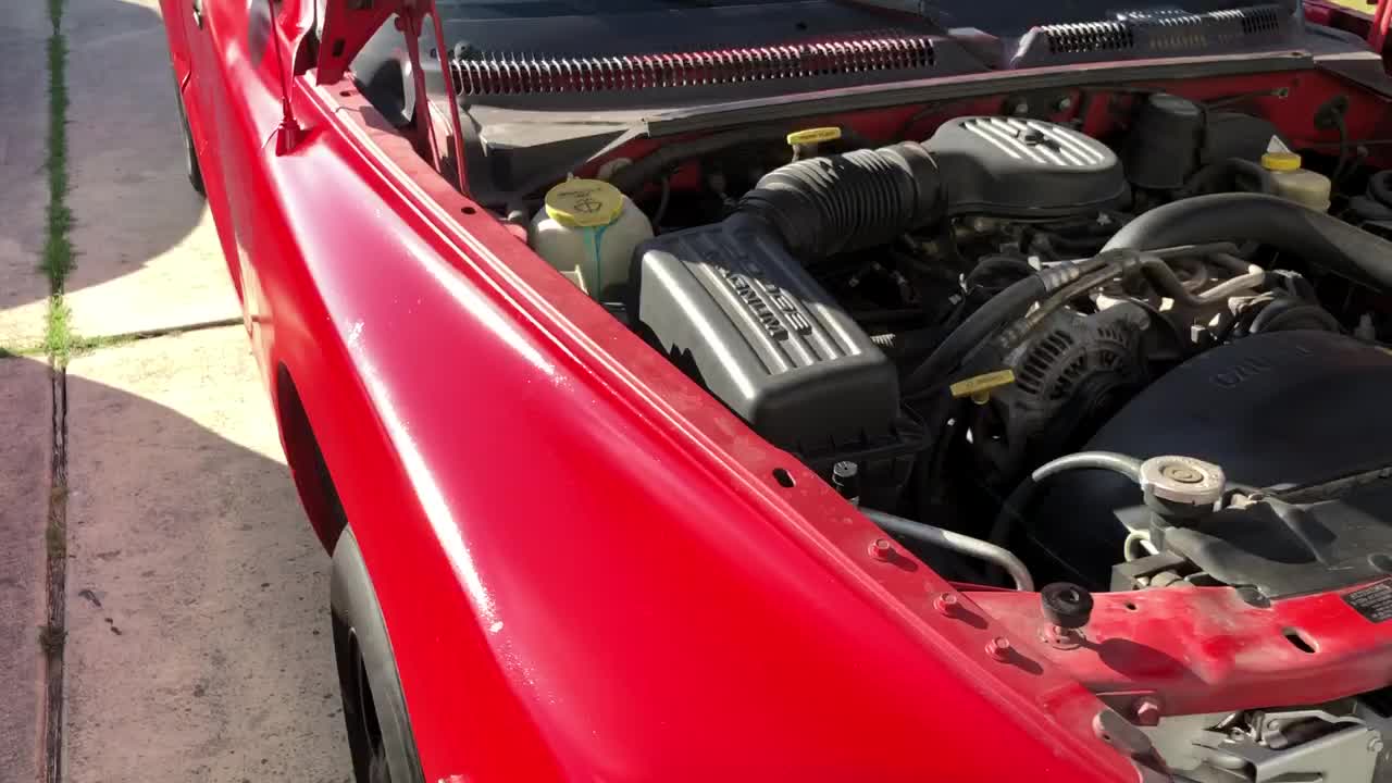

Here is a closer video, it’s still really loud. It does the noise in every gear, park and neutral, o/d on and off. Only thing that silences it, is accelerating. (Meaning in idle even if I increase rpm the sound doesn’t change.)
Doesn’t really sound like metal to me, since it’s a consistent ringing sound, but pitch does change if I’m accelerating. No change if just barely touching throttle, more like only when giving it enough acceleration to speed up. The noise doesn’t seem to depend at all on how fast/slow or anything. It’ll be loud idle and loud 70 mph on the highway.

Take the air box and air tube off. Maybe just open the air box like you are changing your air filter then run the engine the same way. It may be a small crack or split in the intake. That would make sense that it goes away when you step on the accelerator because you are changing the pressure in that intake tube.
Let me know if this changes it and we can figure out exactly where that is.

Tried doing that today, just took off the air box and left it slightly open and there were no noticeable changes in the noise.

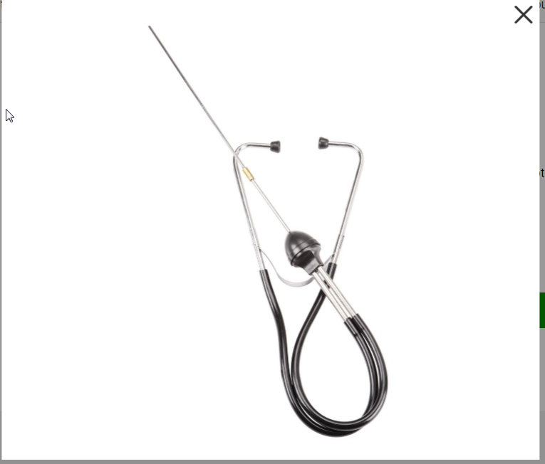

Okay, based on that, it may be the transmission oil pump. That is spinning at a constant speed pretty much all the time and would fit this scenario. However, this is not enough to go on yet to go that route because that requires removing the transmission. Take a look at the picture attached. This is a mechanics stethoscope. They are less than $5 in most cases and the way they work is you put it on your ears and then touch the end to each component around the noise where you hear the noise the loudest and see where the noise is the loudest using this. Basically, it helps you narrow down where the noise is coming from. Let me know where you hear it the loudest with this tool and we can go the next step. Thanks
