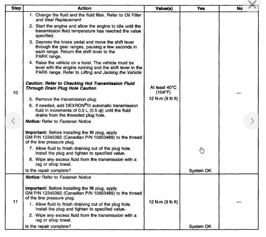

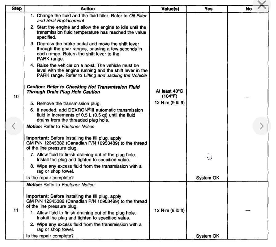

Where is my transmission dipstick located?
Thursday, December 19th, 2019 AT 5:19 PM
MECHANIC
18,907 POSTS

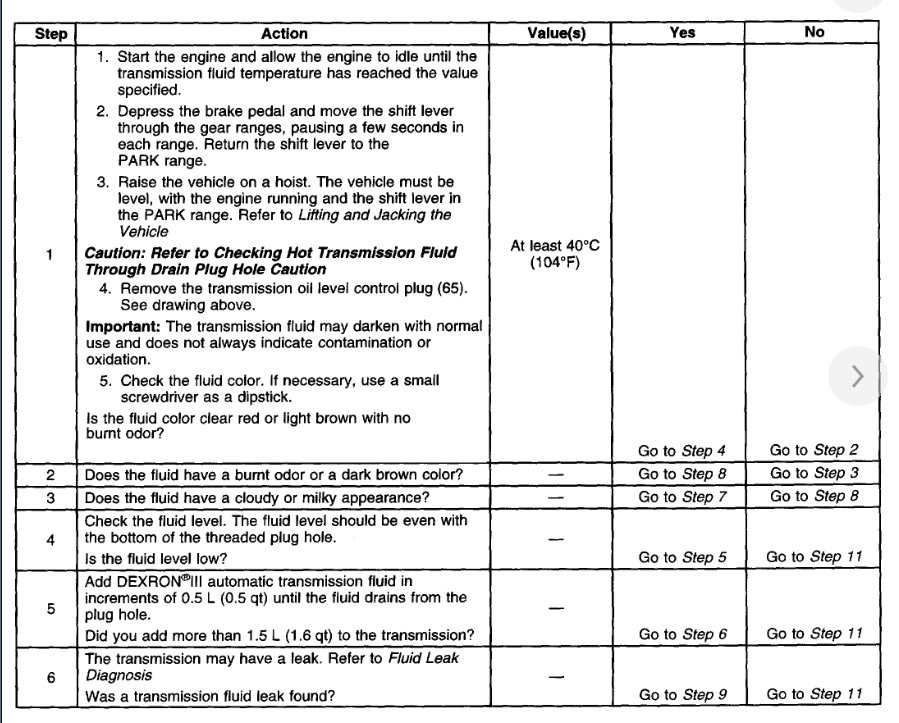

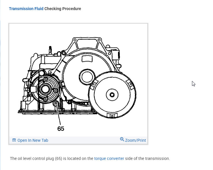

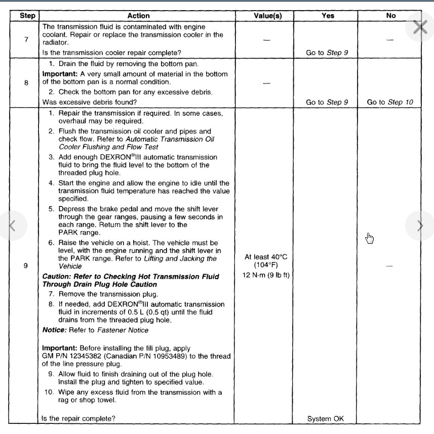

Your vehicle does not have a dipstick. It has an inspection/fill hole. Basically you remove the plug and the fluid needs to be even with the bottom of the hole.
Here is the complete procedure.
