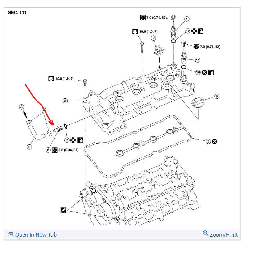

where is the PCV valve located in the engine compartment and how to replace it?
2014 NISSAN VERSA
85,000 MILES • 1.6L • 4 CYL • 2WD • AUTOMATIC
ALEX STATHAS
  • 71 POSTS
I just want to know where the PCV valve is in the engine compartment and how to replace it and how often it must be replaced and whether the engine will seize up with the old PCV valve forming sludge in the engine, is it going to seize up even if I do three month interval bulk synthetic oil changes at Walmart every less than 3,000 miles in three months to combat engine sludge and is Advance Auto Parts' Autotecnica PCV valve an acceptable aftermarket PCV valve?
Jan 18, 2023 at 4:39 PM
  • 54,897 POSTS
Here is the location of the PCV valve in the images below. The engine will not seize up when this valve goes bad or plugs up, but the engine will leak oil or stall at idle. The PCV should be replaced about every 30k miles. Check out the images (below).
Jan 19, 2023 at 4:49 AM
