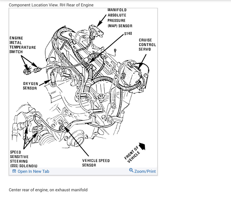

I have the car listed above and am trying to find where the O2 sensor is located. Does anyone have a diagram on where/how I can find it?

I have included the information that you have requested in the diagrams down below. Please get back to us with how everything turns out and I hope that this helps.
