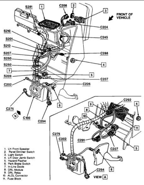

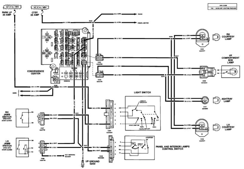

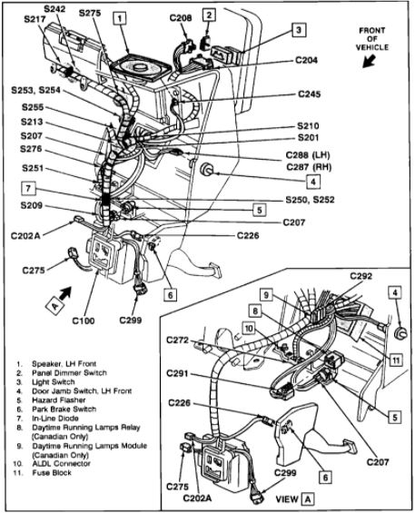

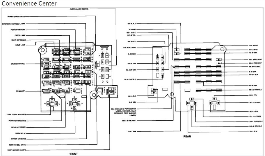

Where is the LPS fuse for the heater
1991 CHEVROLET SILVERADO
240,000 MILES • 5.7L • V8 • 4WD • AUTOMATIC
SHAWN HAMM
have power to controls but it's dark.
Sep 9, 2020 at 8:28 PM
4DRTOM
  • 467 POSTS
The fuse is in the Convenience Center (behind left hand side of instrument panel). I have uploaded the diagram and the appropriate locations of your dash showing the fuses and components involved in the illumination. The bulbs themselves are in the center of the instrument panel at the heater control.
If you need anything else just let me know.
Tom
