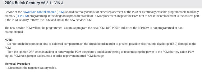

Where is the ECM computer located?
ARO
  • 2001 BUICK CENTURY
  • 3.1L
  • 6 CYL
  • FWD
  • 150,000 MILES

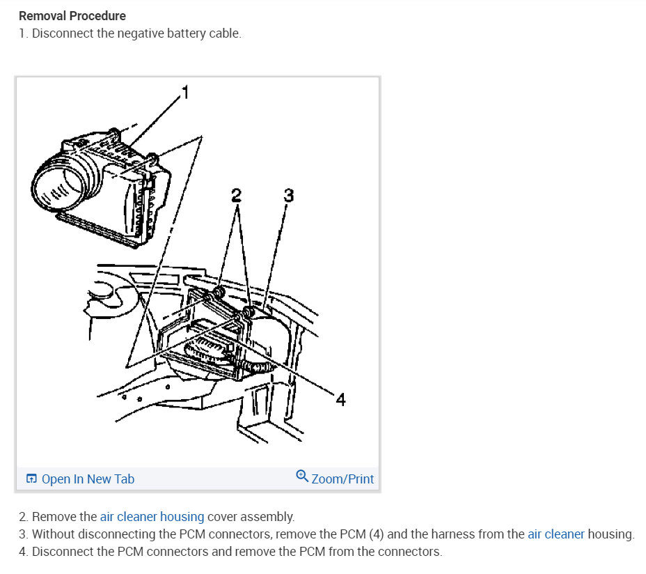

Car will run for about 2 minutes stumbles and dies like its running out of fuel when I'm not getting correct data link between the computer and my analyzer are not working I think it needs an ecm where is it?

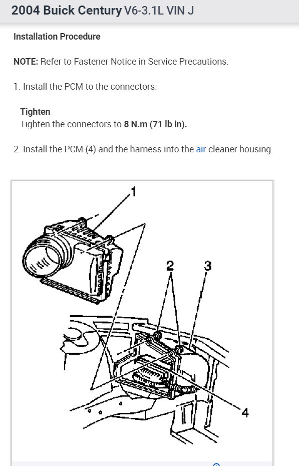

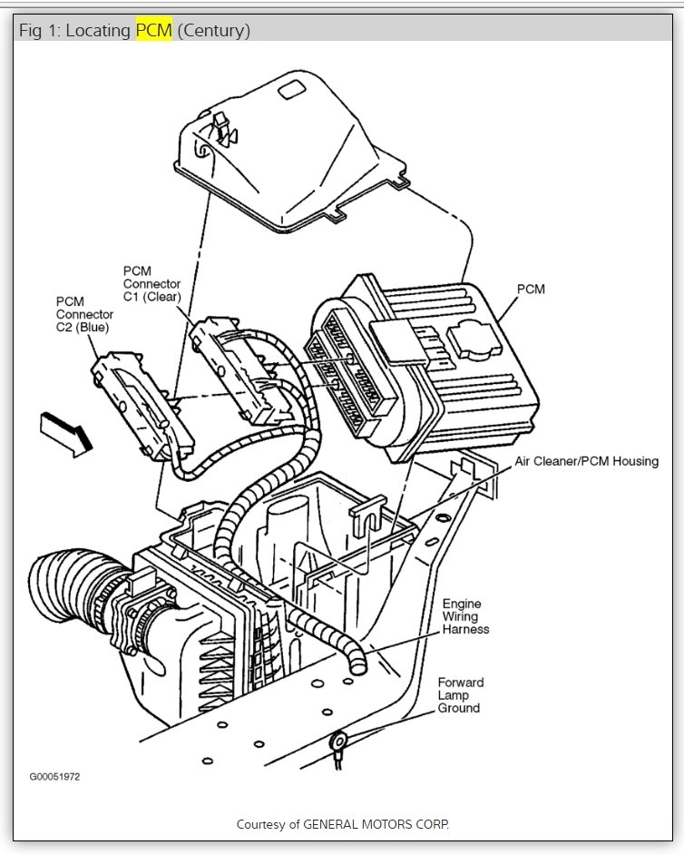

Hey ARO,
It looks like the PCM is located in the front part of the engine compartment on the drivers side. Check out the diagrams (Below). Please let us know what happens.

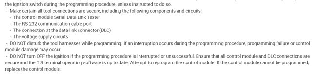

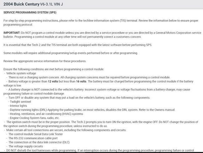

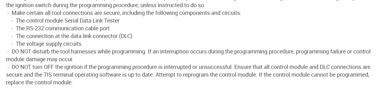

What does it cost to reprogram computer 1n 2001 buick century
+3
Tuesday, December 17th, 2019 AT 2:24 PM (Merged)
BLUELIGHTNIN6
  • 16,542 POSTS
Should just take about an hour which would cost around $70.
