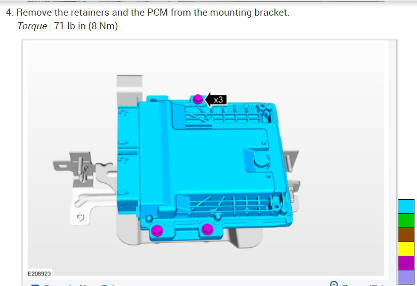

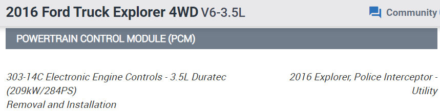

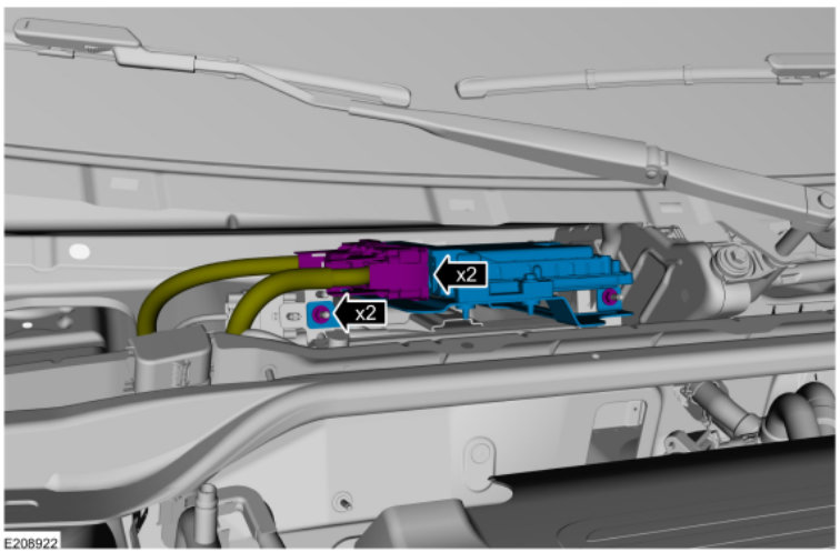

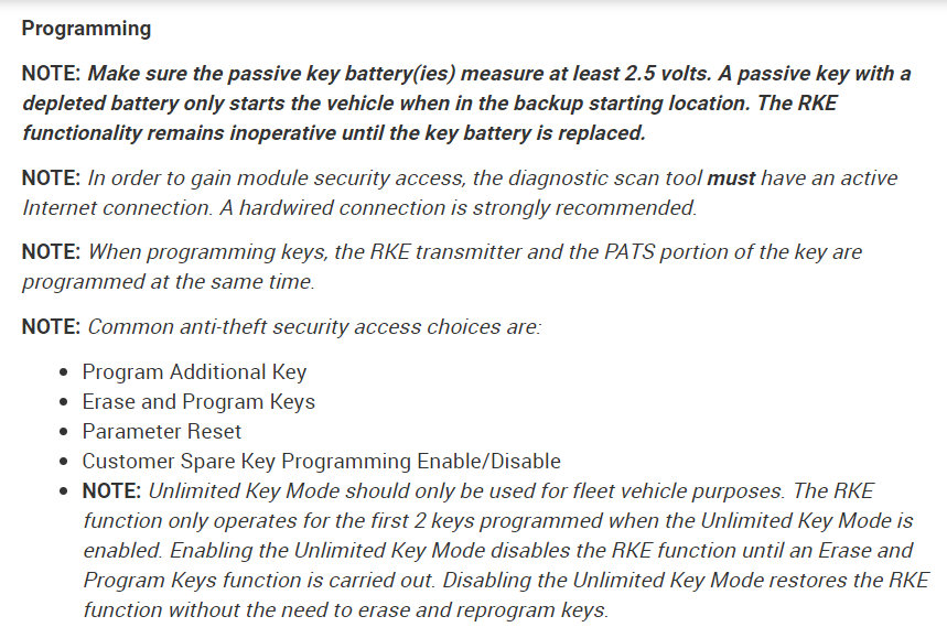

Where is the computer located?
2016 FORD EXPLORER
39,000 MILES • 3.5L • V6 • 4WD • AUTOMATIC
FRANTZ BARON

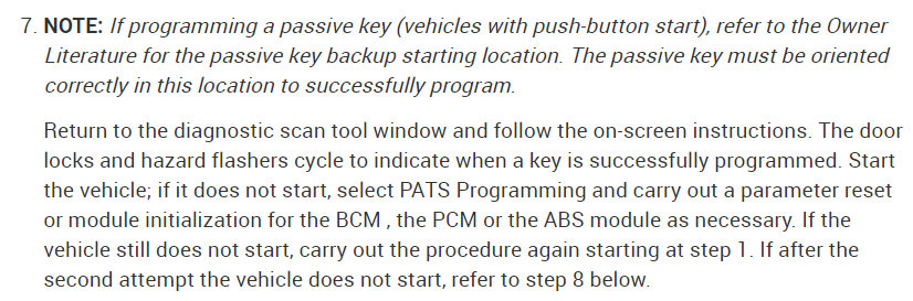

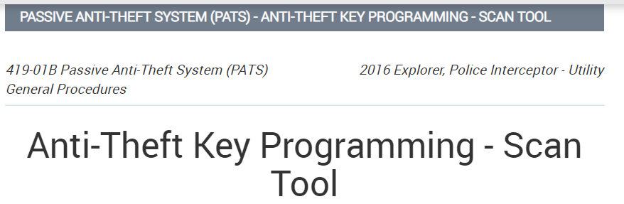

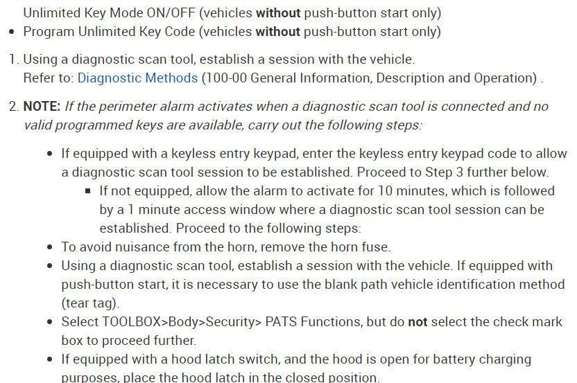

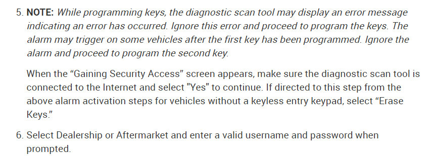

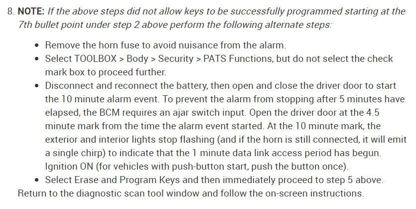

I want to have it tuned.
Dec 30, 2020 at 1:48 PM
DANNY L
  • 5,648 POSTS
Hello, I'm Danny.

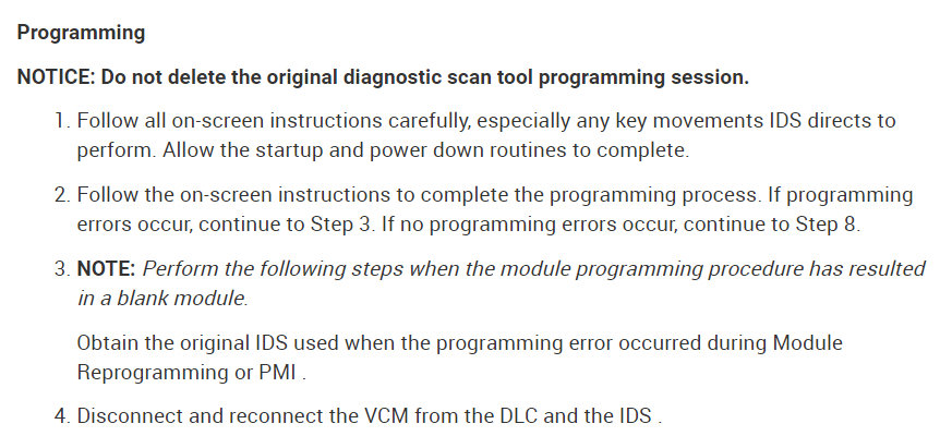

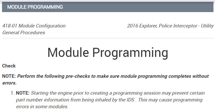

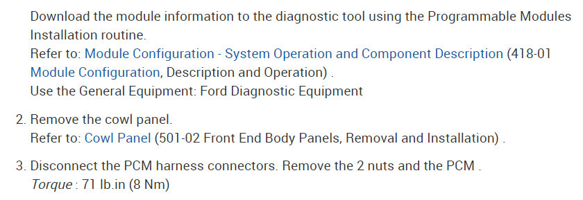

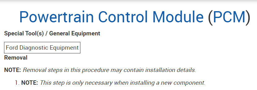

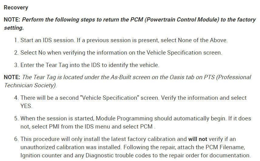

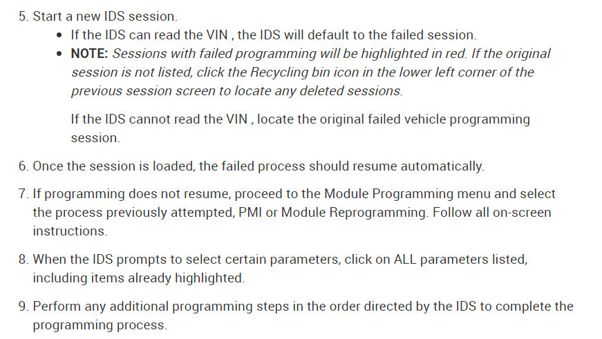

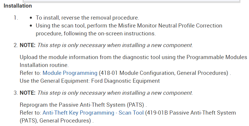

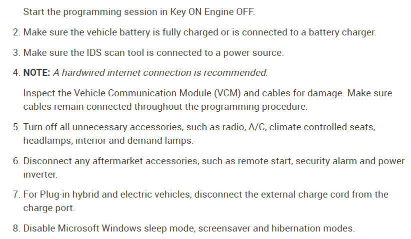

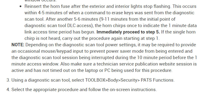

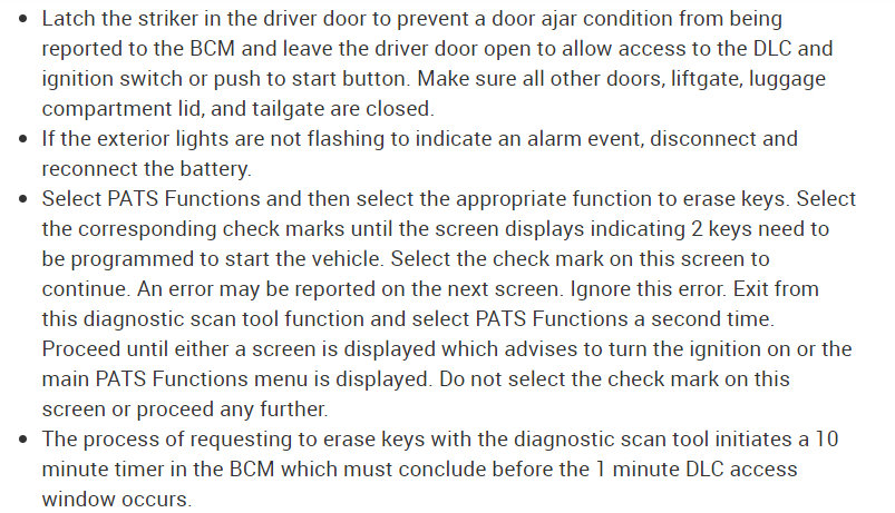

The PCM- powertrain control module is located near the cowl-windshield area. I've attached picture steps below for removal and replacement on your vehicle including its location. If you are going to replace with a new or tuned unit there will be a module and anti-theft key relearn needing to be performed. I've included those steps below as well. Hope this helps and thanks for using 2CarPros. Happy Holidays.
