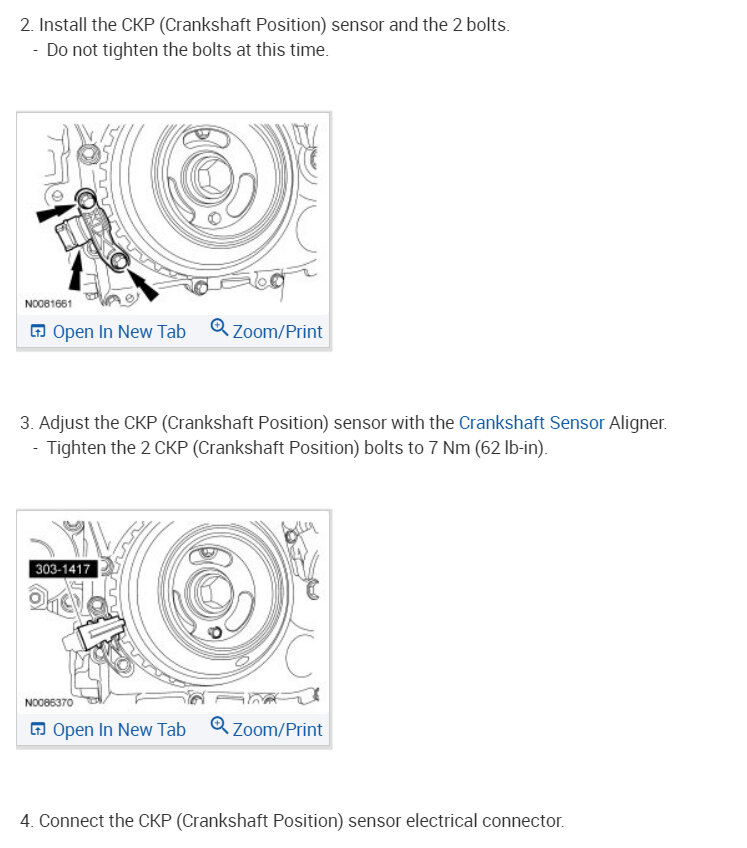

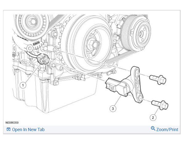

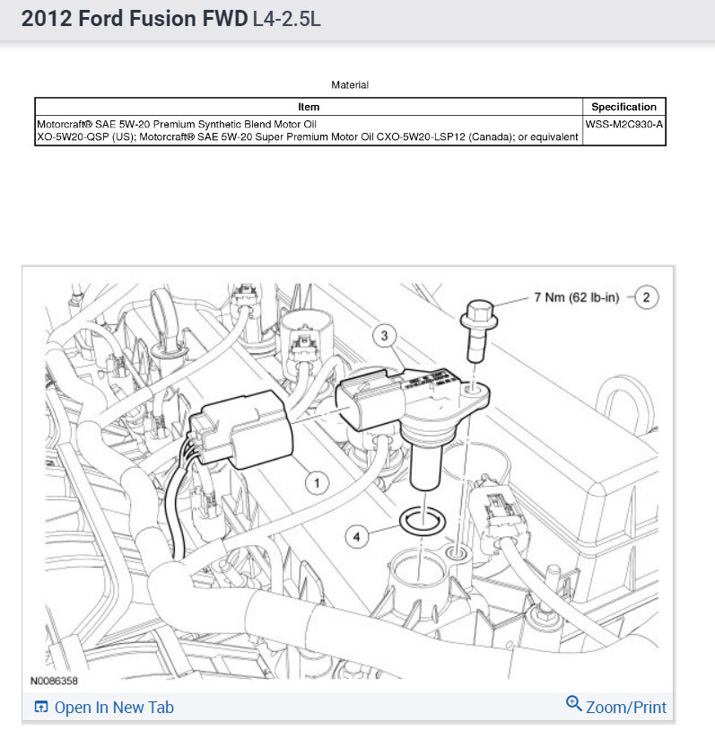

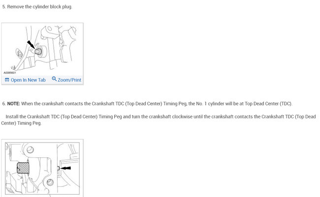

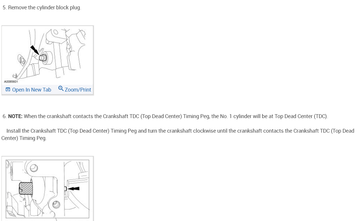

Where is the Camshaft Position Sensor located?
2012 FORD FUSION
144,000 MILES • 2.5L • 4 CYL • 2WD • AUTOMATIC
JOSEPH B.2
Engine cranks but doesn't start.
Aug 2, 2023 at 5:54 AM
  • 55,044 POSTS

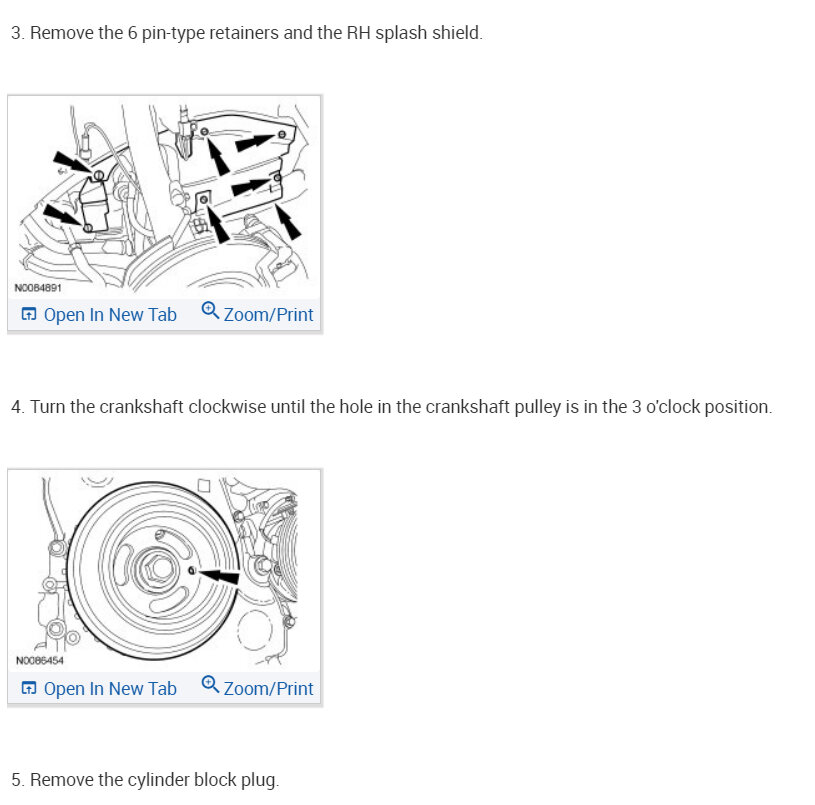

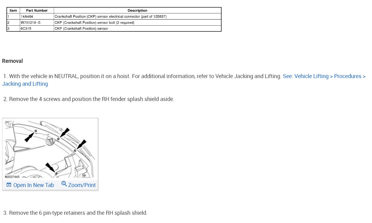

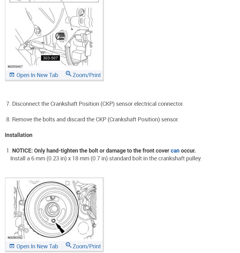

Here is the crankshaft and crankshaft position sensors so you can swap them out, also does the engine run on starting fluid? This guide may be able to help you:
https://www.2carpros.com/articles/car-not-running-advanced
Aug 3, 2023 at 4:07 AM
