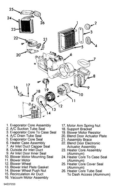

I am haven trouble finding the blower motor. I have started on passager side n I tested all the fuse and the resistor but I just don't know if the blower motor is located on this side of the car. If anyone has pictures or info. Would b greatly appreciated.

I don't know if this diagram will help but... Also I believe it is in the center or just right of center of the dash...

The blower motor for the heat is located just behind the glove box, on the right, under the dash. It's possible to unscrew the holding screws mounting the unit, but easier to see and tackle if you remove the glove box. Take the mounting screws out from under the glove box, and you'll see it there. Disconnect the power cable, remove the 4 tiny screws (6.5 mm is handy on this one) and it should fall out. Careful when removing, as the box has a tendency to break, which really sucks.
