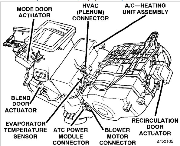

Where is the Blend Door Actuator located and how to replace it?
1994 CHRYSLER LHS
175,000 MILES • 3.0L • 6 CYL • 2WD • AUTOMATIC
SPYCAMSC
Aug 8, 2025 at 12:34 AM
  • 54,494 POSTS
There are 3 blend door actuators, air (temp), mode and recirculation, here are all three. Check out the images (below). Let us know if you need anything else.
