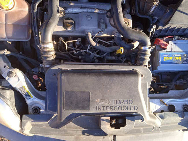

Hello, I asked this question before, but the answer was wrong. The diagram you sent belongs to a 2010 Ford Tournoe Connect. My car is a 2008 model, which is different from the 2010 model, and the temperature gauge is stuck at the end of the needle. There is no lack of engine coolant. I tried the dial salute twice, but the temperature gauge just flickered and did not move. Could you please show me where the temperature gauge is? I added the photo.

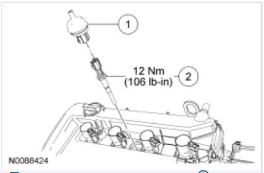

So the easiest way to see if the sensor is working is connect the scanner and go to the readout if it is about the air temperature with the engine cold it is okay. The PCM sends the signal to the cluster for the temperature gauge. Chances are the gauge is at fault if the reading it normal on the scanner. We don't have a 2007 transit in the states, the earliest we have is 2010. It shows the sensor in between the spark plugs. Check out the images (below). Let us know how it goes
