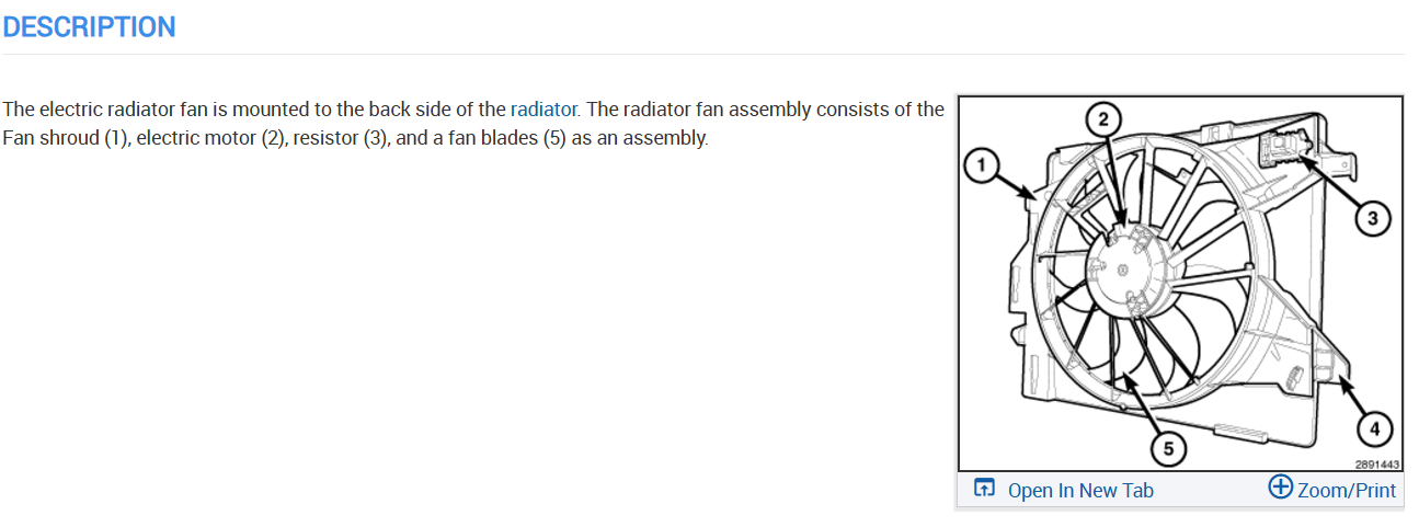

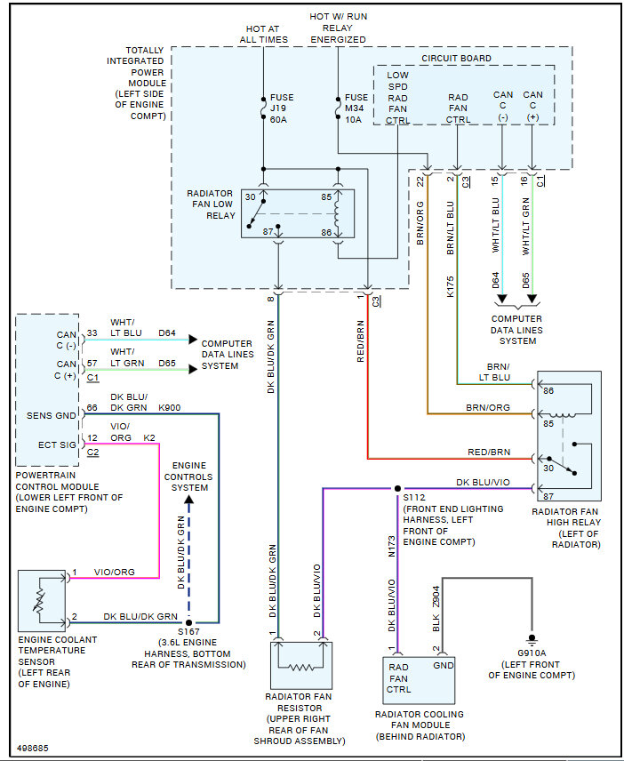

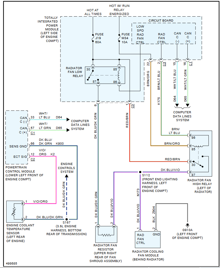

Everything sounds normal from what you have described except the fan not coming on when the A/C is on, But I need to add you may need to leave the A/C on for a while in this cold weather to get the high side pressure switch to trigger. Are you having any other issues besides that? Here are the radiator cooling fan wiring diagrams so you can see how the system works also, the fan control module is on the fan shroud, they call it a resistor FYI. Check out the images (below). Please let us know what happens.

Thankyou Ken, just what I needed. Bought 2 months ago with issues. Over heating - changed out oil cooler leaking both oil and water. Fans never came on. A/C works fine fan never came on. I was able to trace and figure out last night that low speed B+ is supplied by relay k11 in the TIPM (which I see is being triggered by a separate circuit board built into the TIPM - relaying the engage data from the PCM) and high speed is supplied by the large relay under the left head light (being fed by the PCM relaying the engage from data lines. Am I correct in assuming that unplugging the Coolant temperature sensor is engaging the fan through default mode? I haven't checked which relay is feeding the fan, but I am assuming it's high speed (having never heard the fan before). Both HVACs are charged properly and operate properly, just no fan. This kind of leads me to the PCM and my ignorance does not know where the data lines come from. Is this from the PCM? Since both low and high are not being activated the common thread is the PCM or wiring from the PCM? Your input is greatly appreciated. Your schematic is much more complete than the one I made and very helpful. If you have further input, I'm sure it would be helpful and time saving. Any common culprits in this scenario that you know of?

I'm going to hold off on pulling the TIPM apart to find whatever circuit is buried in there as I do believe it is something affecting signal from data to both the TIPM and the large relay.

I answered all my questions by studying the schematic. Next step I'm going to pull the c1 connector on the PCM, where I think the issue is. Second step if not there, trace wires to TIPM check that connector. I'll let you know what I find... Might be a few days before I can get back to it. Thanks again...

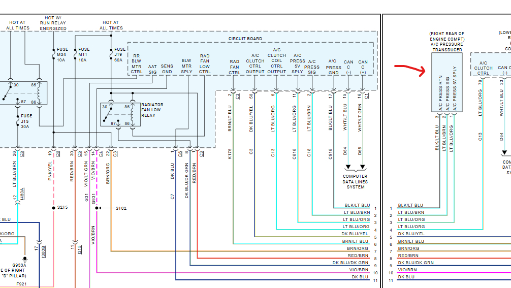

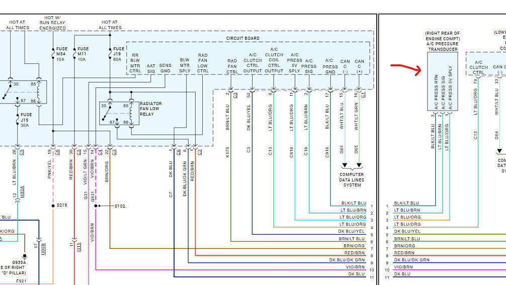

Cleaned connectors on PCM. Did following tests. Grounded k11 in TIPM - low speed fan engaged. Grounded High speed relay with engagement. Replaced ECT with plug and let ECT hang and heated up with lighter. High speed fan responded @ 234 degrees. I looked up ECT resistance/temp chart and found measured resistance to be considerably high. Current ECT is aftermarket. Will replace with OEM. There are three wires on the high-pressure HVAC sensor. Is there a way to jumper/disconnect to get PCM to turn on fan? Does the high-pressure switch trigger the low-speed fan?

I would not mess with the AC pressure switch, there is a 5-volt reference and two sensor and compressor wires, you might be able to jump them, but you might blow out the TIPM as well. Check the wiring diagrams below.
