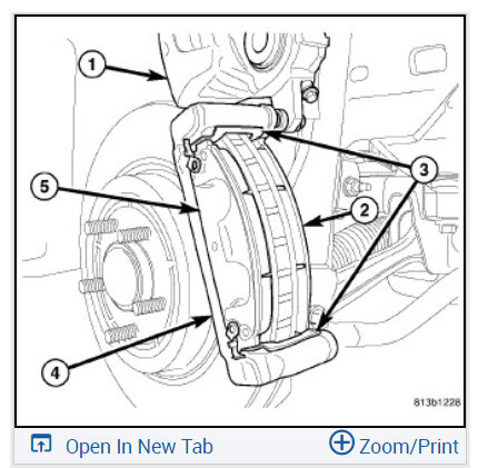

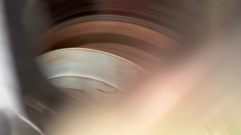

I hear brakes scraping and a slight bearing rolling around inside tire. I noticed it when checking tie rods and I moved the wheel side to side but not up and down and I spun the wheel and could hear loud scrapping noise and sounded like little bearings rolling around but couldn’t hear a growl noise.
Tuesday, August 27th, 2024 AT 1:30 PM
17 Replies
KEN L
  • MASTER CERTIFIED MECHANIC
  • 55,488 POSTS

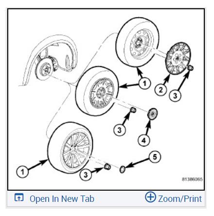

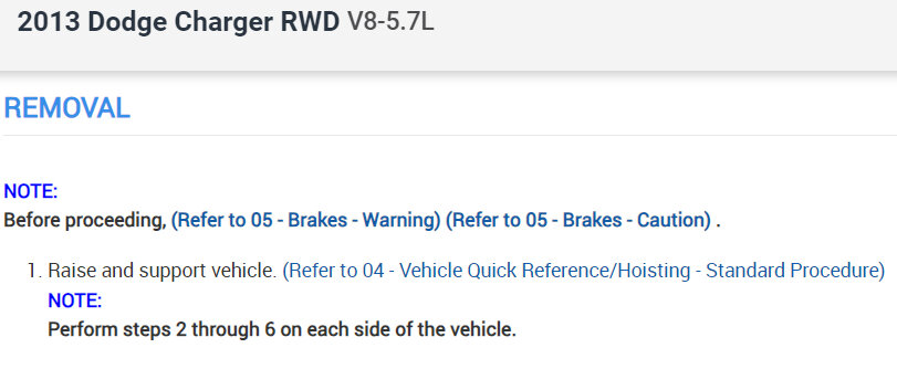

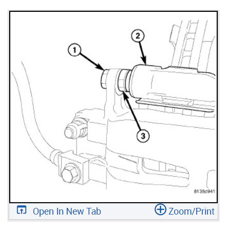

Can you please shoot a quick video with your phone so I can hear the noise? That way I can tell for sure what's going on. It sounds like you have a wheel bearing hub that is bad, or the brake pads need to be replaced. Here is how to check the brake pads. Check out the images (below). Please let us know what happens.

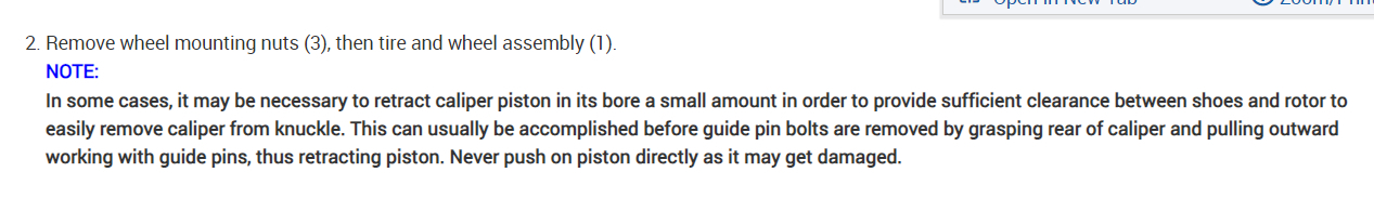

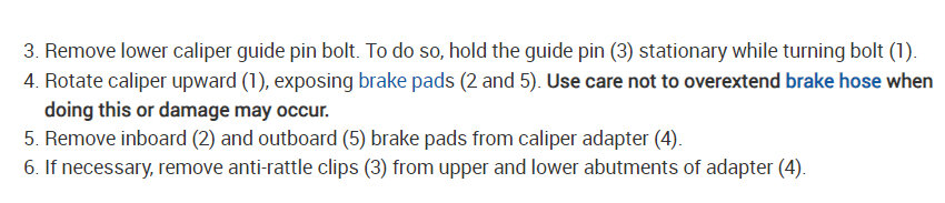

I would remove the brake pads and caliper to see if the noise goes away, if so look at the brake pad anti rattle clips to see if they are touching the rotor. Thanks for the video, it helps.

Not to me, try removing the brake caliper and pads to confirm.
Wednesday, August 28th, 2024 AT 9:04 AM
SKOOTER28
  • 98 POSTS
Okay, so, if noise goes away, it’s in the caliper if it doesn’t go away most like melt the hub, correct?
Wednesday, August 28th, 2024 AT 9:08 AM
KEN L
  • 55,488 POSTS
Yes. Please let me know.

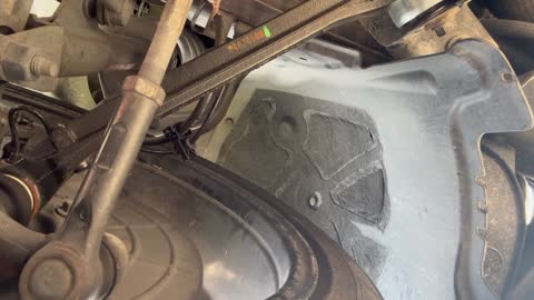

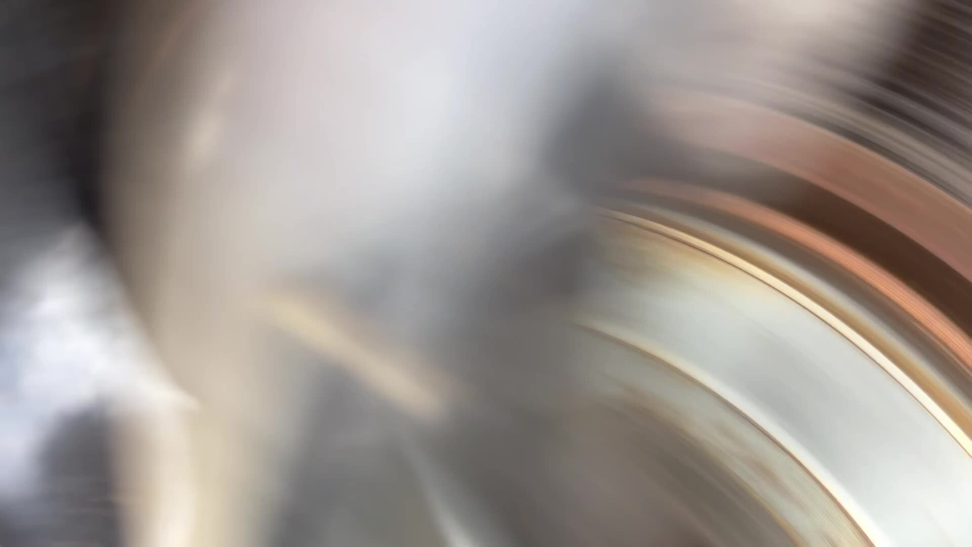

Here is another video I forgot to send with it.

Thanks for the video, can I ask what was making the noise was it the brake pad anti-rattle clips?
Thursday, August 29th, 2024 AT 10:21 AM
SKOOTER28
  • 98 POSTS
I believe so I haven’t had time to get the tires off yet I’m about to in a few but I think your right cause we had this caliper replaced by the dealer and I have a feeling they don’t do something right.
Thursday, August 29th, 2024 AT 10:23 AM
SKOOTER28
  • 98 POSTS

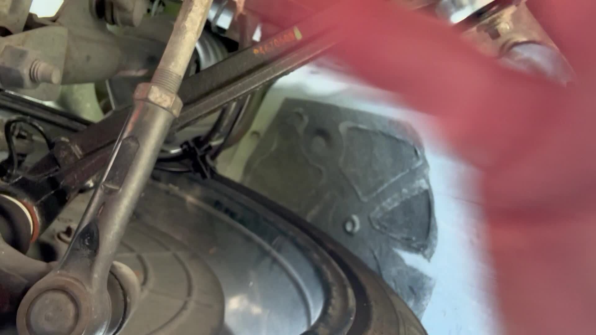

But I also have movement back and forth on this tire but not on the other can you see anything in the video that I might be missing.
Thursday, August 29th, 2024 AT 10:32 AM
KEN L
  • 55,488 POSTS
The framing of the video is a little off for me to see everything, can you please reshoot it?
Thursday, August 29th, 2024 AT 11:22 AM
SKOOTER28
  • 98 POSTS
I’ll reshoot it. I’m going to get someone to shake it while I record.
