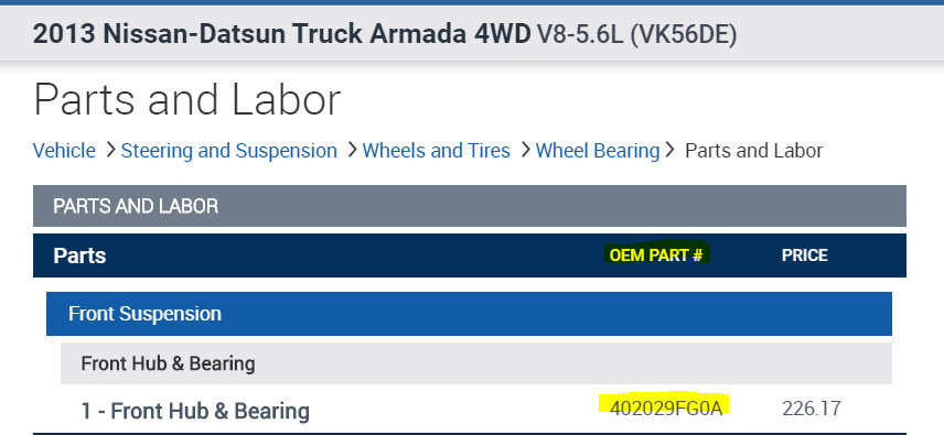

Hello. Good morning.
Can you provide the part number for wheel bearings for my 2013 Nissan Armada sv?
Oct 17, 2019 at 7:24 AM
SCGRANTURISMO
  • 4,897 POSTS
Hello again,
I have included the information that you requested in the diagrams down below. Also, have you checked the level of your vehicle's power steering fluid to make sure it's okay?
