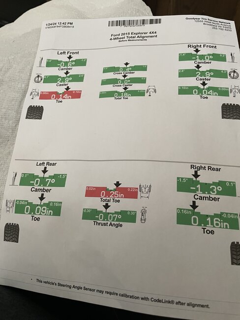

Just had tires rotated and Goodyear did a courtesy alignment check, here it is. any concerns/do I need an alignment?

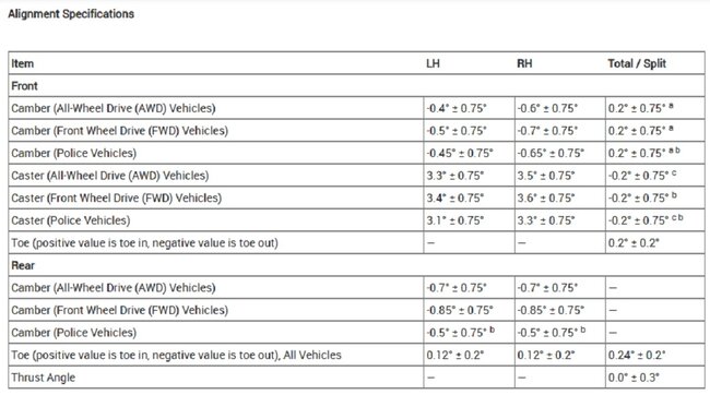

There's "normal specifications for caster and camber, and then there's specifications for Fords. They use uncommon values to achieve the best handling and ride quality with tire wear being less important. As such, I have to rely on those factory specifications. They're in the first image below.
Tire wear takes some time to show up. The other two concerns are whether the vehicle pulls to one side when you let go of the steering wheel, and if the steering wheel is straight when driving on a straight road. If those are okay, the alignment can probably be left alone.

There's "normal" specifications for caster and camber, and then there's specifications for Fords. They use uncommon values to achieve the best handling and ride quality with tire wear being less important. As such, I have to rely on those factory specifications. They're in the first image below.
So, to answer your question, if your steering wheel is straight and there's no noticeable pull, your vehicle's alignment is probably okay. Check the tire wear two or three times per year. Watch for accelerated smooth camber wear on the inner edges on the front tires, and a little choppy total toe wear on the rear.

The question here is how hard should the service writer try to sell you an alignment? This isn't a question of "yes" or "no". Rather, it's how much better do you want to make it? The numbers suggest there's plenty of room for improvement, but in my opinion, the money spent would not be a good value. You haven't said yet if there's a pull and whether the steering wheel is straight, so all we have to go on is tire wear. That's up to you to keep an eye on.

The numbers on your printout suggest the vehicle should pull to the left when you let go of the steering wheel. If that disagrees with what you see when driving, it means your vehicle is rather forgiving of the mismatched camber, then, since both values are in green, it means they're both in specs as far as best tire wear. This is why I said there's always room for improvement, but considering the cost, an alignment is probably not a good value right now. You won't see much improvement for the money spent.
