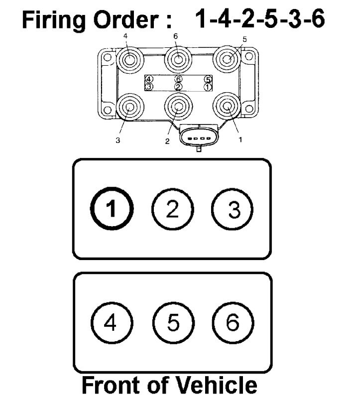

My firing order started, and it backfires every time I start it so I want to know what is the firing order so I can set it.

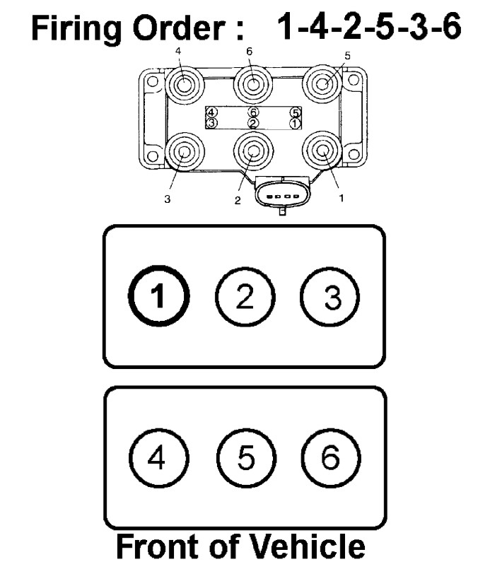

Hello, the firing order is 1-4-2-5-3-6 for the MPV LX, I'll post the coil and cylinder ID as well for you, 1 sec.

This is for the LX; the ES is the same.
Image (Click to make bigger)
