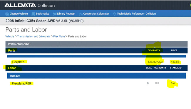

Is there a knocking you are hearing? As far as the flex plate, labor is 5.4 hours for removal and replacement. So at $1,300.00 for labor indicates he is charging over $240.00 per hour. That's crazy! As far as the part, the OEM part shows to be $433.85, so that is high as well.
I attached a pic below for you to see the parts and labor for this job. The price on the part is for an original equipment part. I'm not sure that an aftermarket is available, but chances are you could find a good used one from a salvage yard. It's just a thought.

I'm sorry that I didn't get back with you last night. It was late here. As far as the idea that you lost power and the vehicle wouldn't accelerate seems to indicate that it may not be a simple flex plate. As far as the labor, simply tell him you have access to Alldata manuals online and you looked up the flat rate for the repair and it shows 5.4 hours to remove and replace the part.

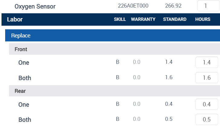

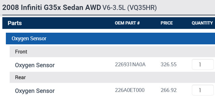

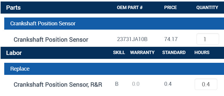

How many labor hours to replace 02 oxygen sensor and crankshaft position sensor in 2008 infinite G35x?
Wednesday, July 29th, 2020 AT 10:00 PM
DANNY L
  • 5,648 POSTS
Hello, I'm Danny.
I've attached the information you've requested below. Hope this helps and thank you again for using 2CarPros.
