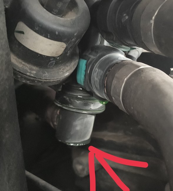

Hi, I need to know what part it is so I can buy it online and replace it myself. It is leaking coolant fluid. Please see image. Thank you

This is the internal heater outlet hose connection, part number 1371567
