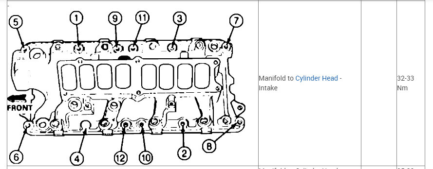

I figured it outm thank you. Do you happen to know the torque specs for the upper half also what torque order?
Saturday, May 13th, 2023 AT 10:37 AM
  • 110,194 POSTS
I'm glad you figured it out. As far as the torque specs are concerned, I attached a pic below that provided the torque and the sequence to tighten them.
The torque is listed in newton meters which is 33Nm. That is equal to approx 25 foot-pounds.
Let me know if that helps or if you have other questions.
See pic below.
