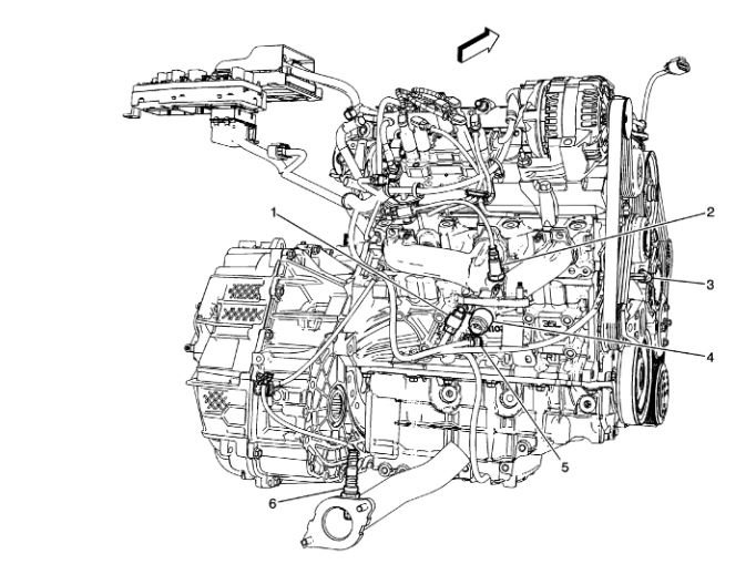

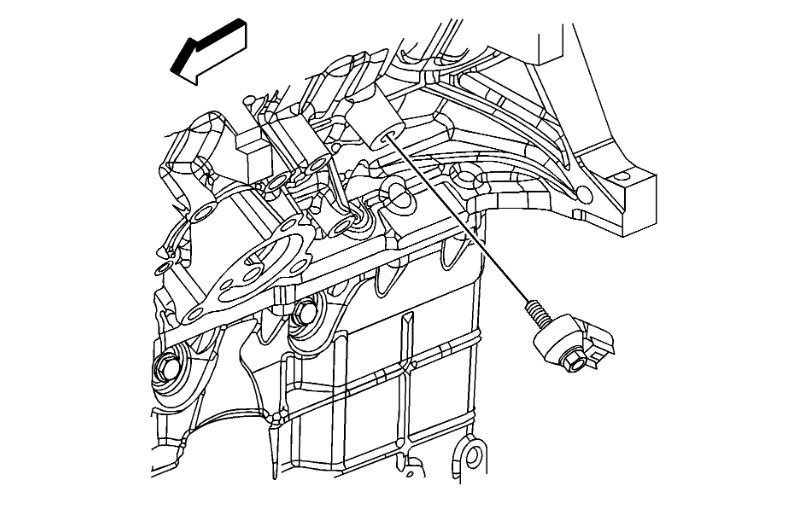

Codes P0137 and P0332
2008 SATURN VUE
95,000 MILES • 3.5L • 6 CYL • 4WD • AUTOMATIC
LARRY BIRT
Codes P0137 and P0332 both indicate low voltage. What is common to Knock and B1 O2 Sensor 2?
Apr 25, 2019 at 1:49 PM
LARRY BIRT
That was supposed to be P0327: Bank 1 knock sensor low And P0137: O2 Sensor Circuit Low Voltage (Bank 1, Sensor 2)
Apr 25, 2019 at 6:57 PM
Good afternoon,
The 327 is a knock sensor. The possibilities are below:
P0327
Descriptor
Probable Causes
Engine Control Module (ECM)
Knock Sensor
137
P0137
Descriptor
Probable Causes
Diagnose Other DTCs First
Engine Coolant Consumption
Engine Oil Consumption
Fuel Quality
Heated Oxygen Sensor (HO2S)
Heated Oxygen Sensor (HO2S) Bank 1 Sensor 2

Rear of the Engine
1 - Knock Sensor (KS) Bank 1
2 - Heated Oxygen Sensor (HO2S) Bank 1 Sensor 1
3 - Camshaft Position (CMP) Actuator Solenoid
4 - Engine Block Heater Connector (K05)
5 - Crankshaft Position (CKP) Sensor
6 - Heated Oxygen Sensor (HO2S) Bank 1 Sensor 2
