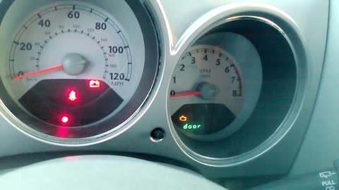

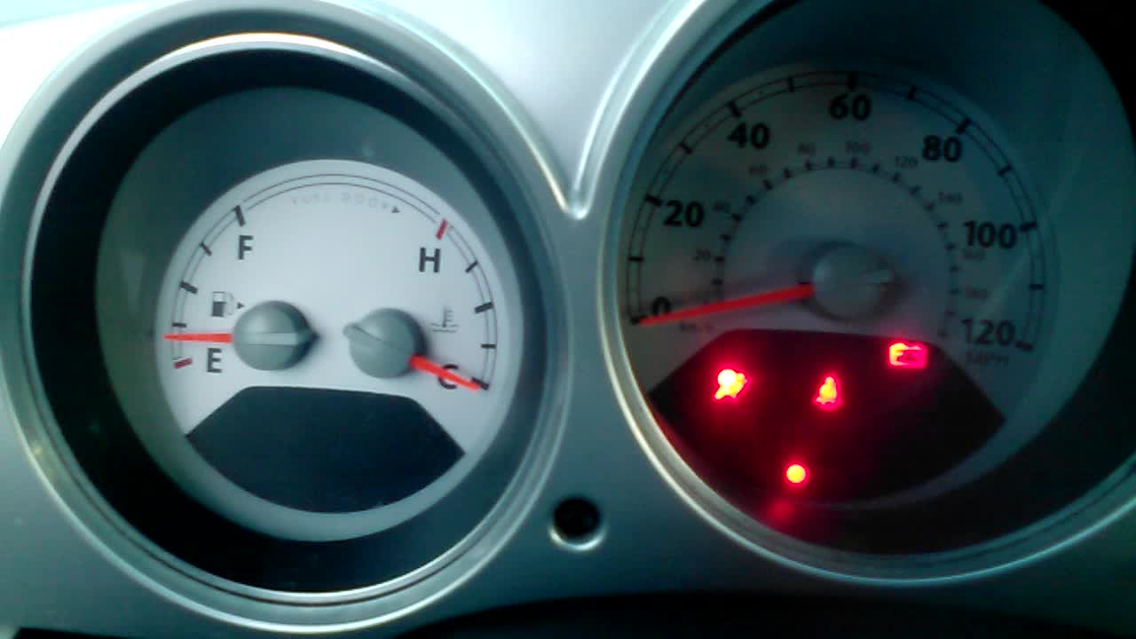

This video is recorded when key on engine off. When I depin two B+ wires from the pcm C! Connector it does same thing you see in the video so I suspecting the splice between ignition switch and the B+ wire going to the pcm. The splice is s118 how to locate it?

The problem is sometimes not always when I turn the key to run position engine off I see what's in the video after I crank it and the car start normally however the car goes in limp mode with p0882 code. So what I did I disconnected the c1 connector, turned the key on run position engine off and I saw what's in the video so I said the problem is tin that connector. To pinpoint where exactly I Depin two power wires from c1 connectors one comes from ignition switch the other from tipm and connect back the c1 connector turn key on engine off and I saw what's in the video so my conclusion is the problem is in those two powers one of them has a splice the other not. So I want to check the s118 splice for problems

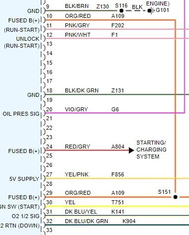

Take a look at this schematic and tell me if you are referring to pins 10 and 29. If you are, the only splice I can find is s151.

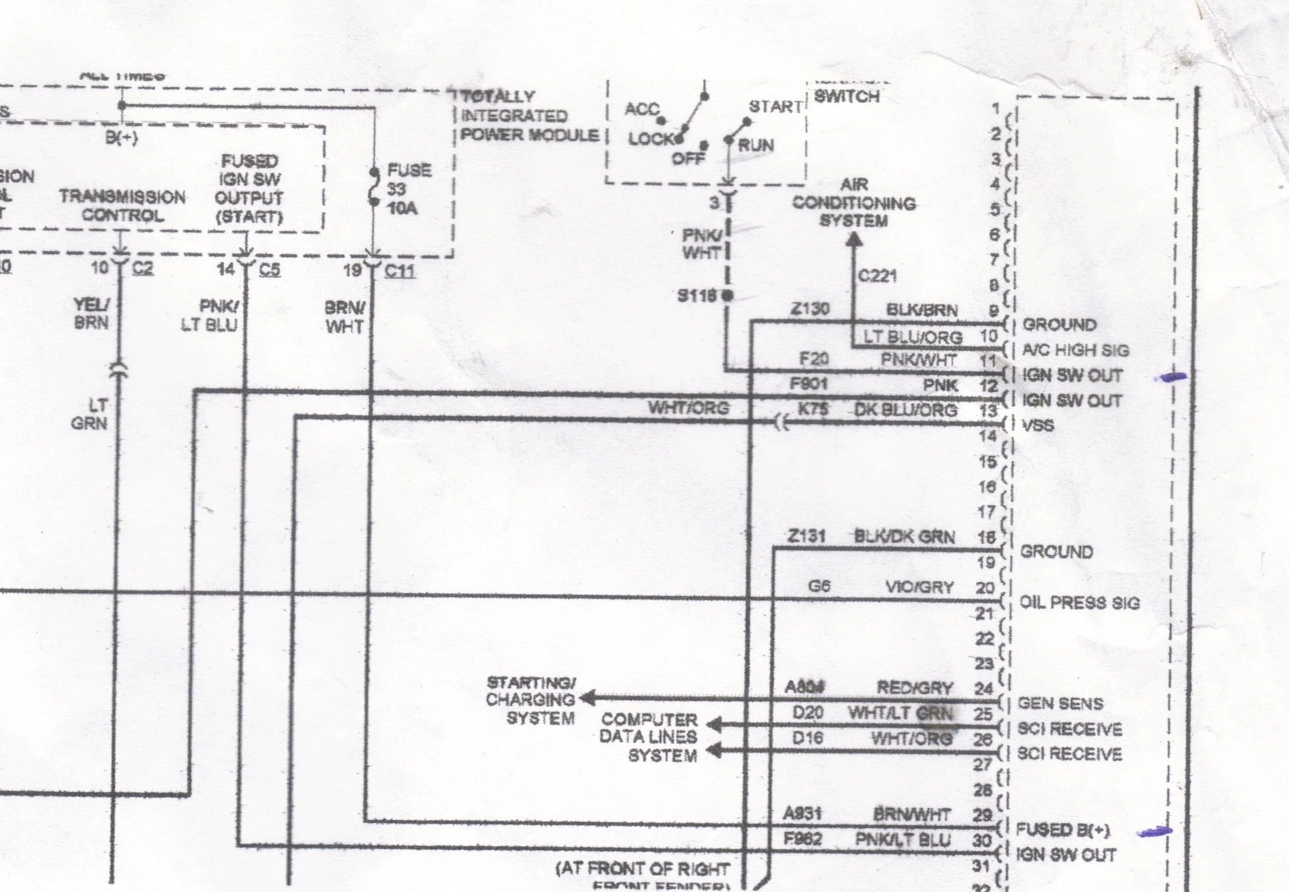

Its #11 its ignition switched and 29 came from tipm. When I disconnect those two pins from the pcm connector, connect back the connector to the pcm and turn the key to run position engine off the recreate the problem that I have shown on the video

This is really interesting. Your wiring schematic looks different than mine. What size engine does it have? To answer your question, 99% of the time it is the actual pins on the tipm. They bend or corrode and break.
I looked on my schematic. Both B+ terminals are to power the fuel pump (at least that is what my schematic is showing me). I don't see how that would put it into limp mode.

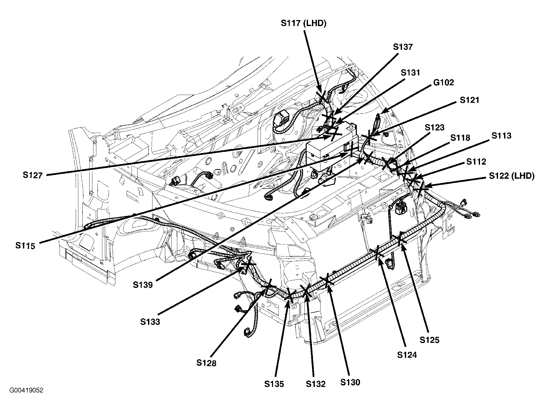

That makes a difference. The splice is located on the left front side of the engine compartment. See attached picture.
Let me know if this helps.

So what I need to look for? And on the image what those doted line coming from the ignition switch to pin 11 of the PCM means?
Monday, October 29th, 2018 AT 10:07 PM
  • 110,194 POSTS
The dashed line indicates it is a switched power. Have you checked the splice?

When I depin pin#11 from connector C1 of the PCM and connect all PCM connectors back the car does exactly the same as shown on the video. Also 5 volts reference is present, when I depin pin#12 the car does not act up. When I depin pin# 29 aka remove the fuse the car acts up the difference is there is no 5 volts reference. FYI when the car acting up as in the video there is 5 volts reference so I am sure the problem is in pin#11. The other thing is when the car acts up and back probe pin#11 there is battery voltage
Pin #11, 12, 29 are all in C1 connector of PCM.
Tuesday, November 6th, 2018 AT 1:06 PM

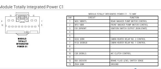

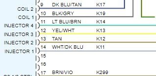

Are you referring to the TIPM C1 connector or the PCM? The C1 connector on the TIPM pin 11 is not used. Pin 11 on the PCM is for injector 4. See the attached pictures.
Tuesday, November 6th, 2018 AT 6:03 PM

I corrected the car on one of my answer it is 2006 PT Cruiser 2.4 L non turbo automatic. Sorry. I am talking about C1 of PCM this is the diagram.
