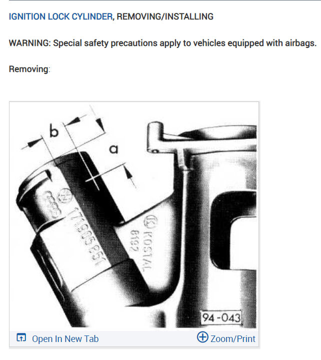

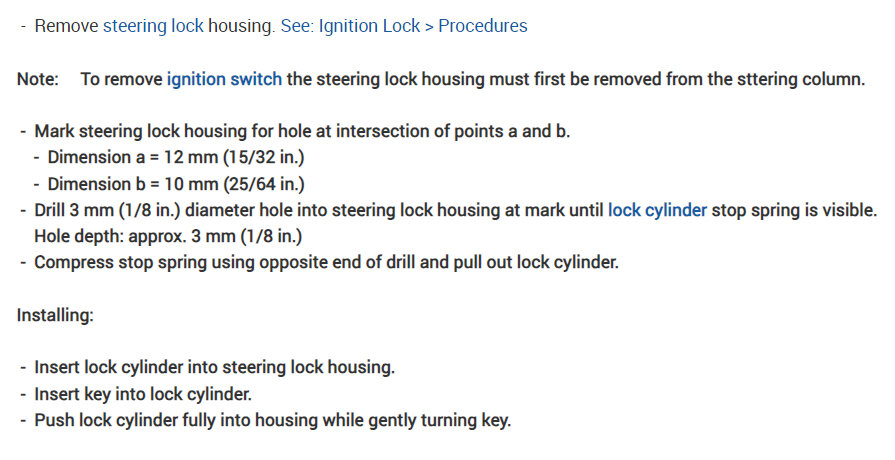

It sounds like the key warning switch inside the ignition key tumbler has gone bad, I would check all fuses and then switch the ignition lock out for a new unit. Check out the images (below). Please let us know what happens.
