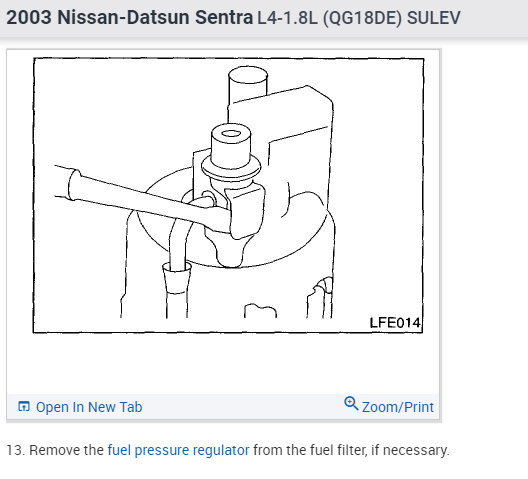

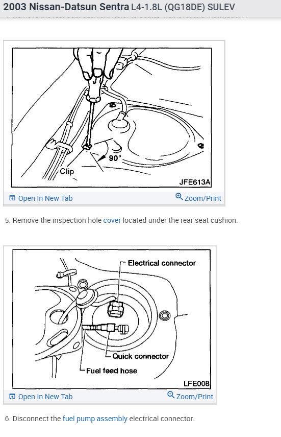

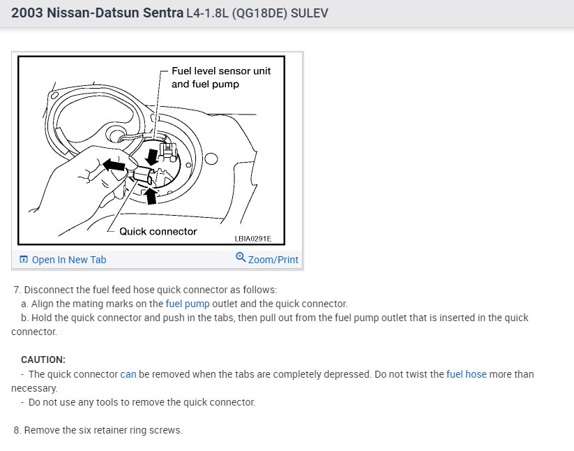

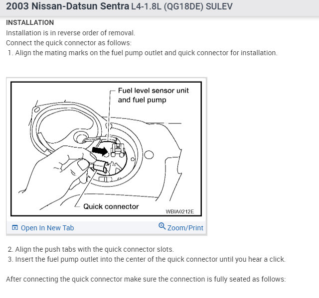

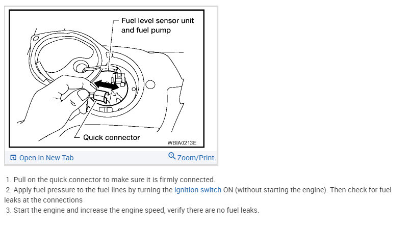

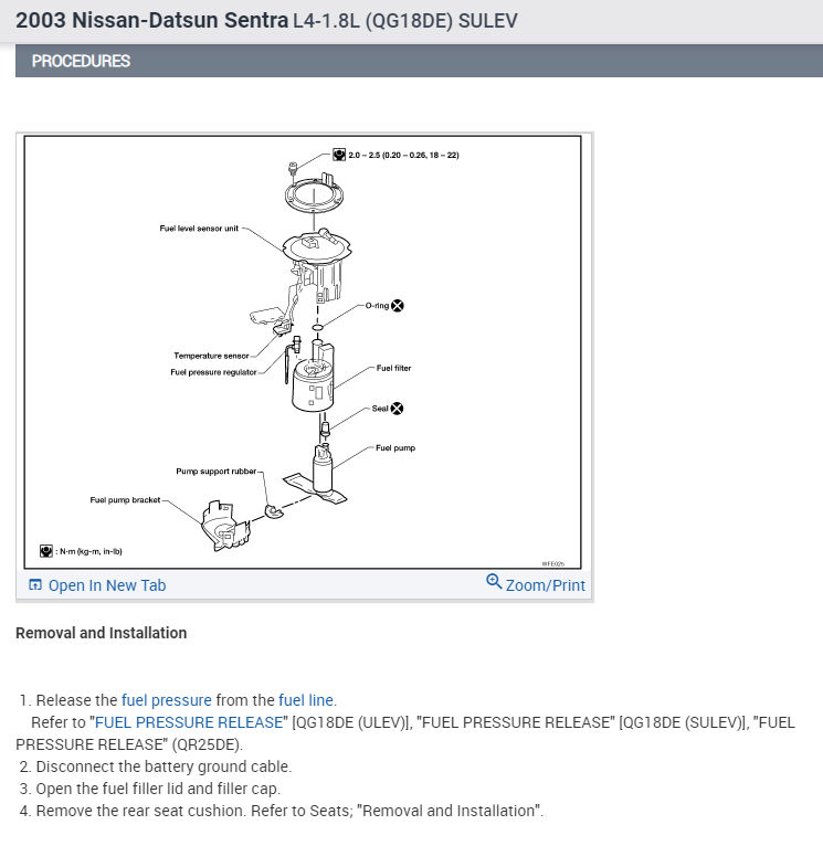

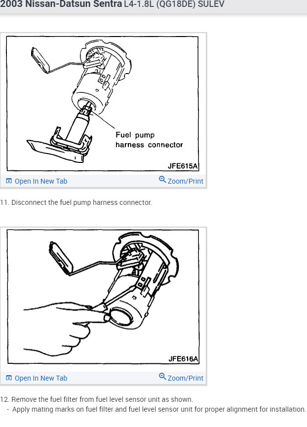

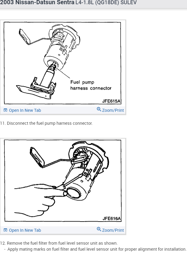

Hi, I'm trying to see where the fuel filter is on my car listed above GXE model. Because I need to change my fuel pump.
Wednesday, April 27th, 2022 AT 2:48 PM
SQM
MECHANIC
6,383 POSTS

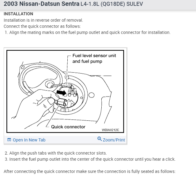

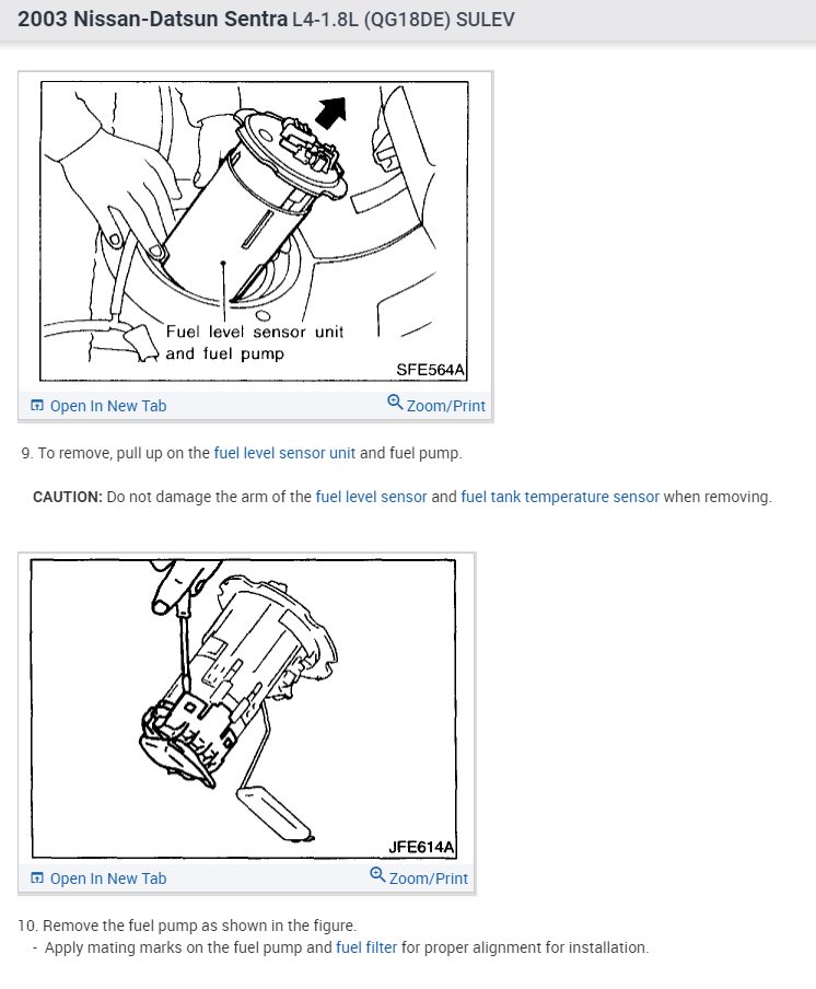

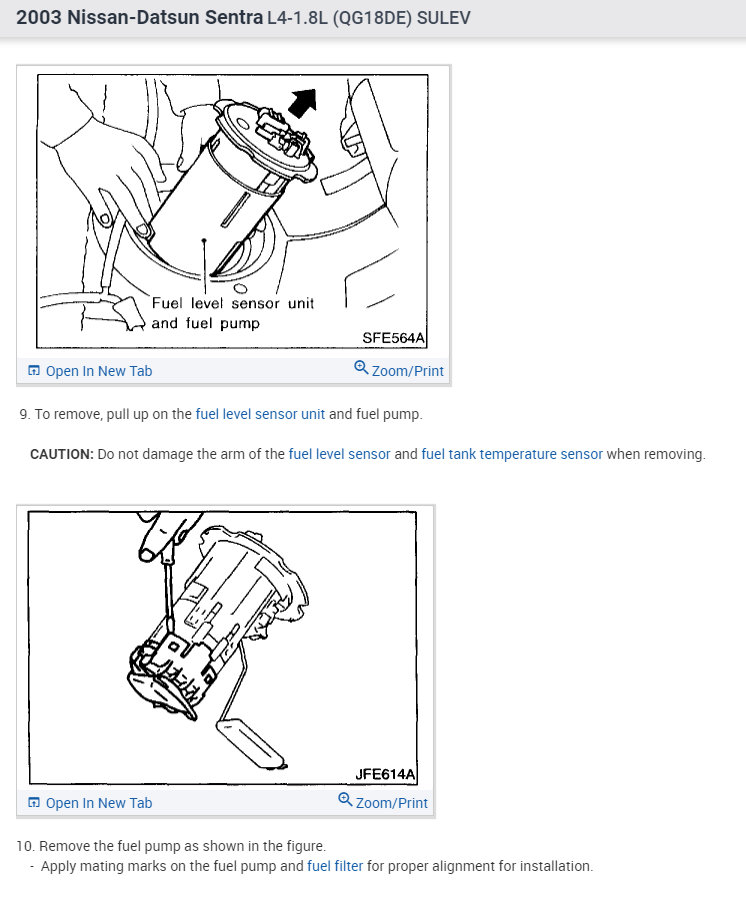

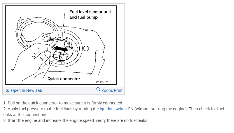

This vehicle does not have an inline fuel filter. The fuel filter is part of the fuel pump.
I have attached the fuel pump replacement procedure below for your reference.
Let me know of any questions.
