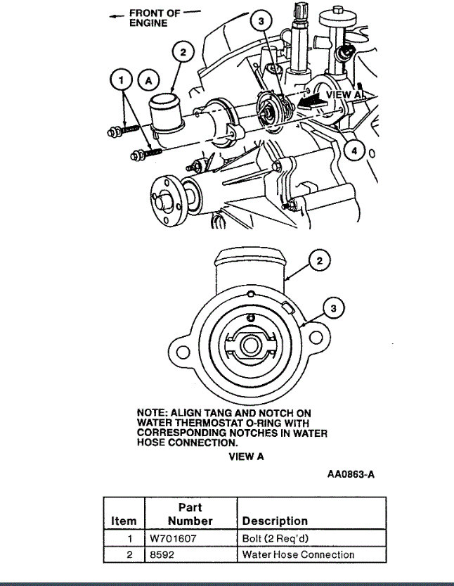

Is the coolant clean and full in both the radiator and the reservoir? When they fluctuate as you described, oftentimes they are low on coolant. Also, have you ever replaced the coolant thermostat?

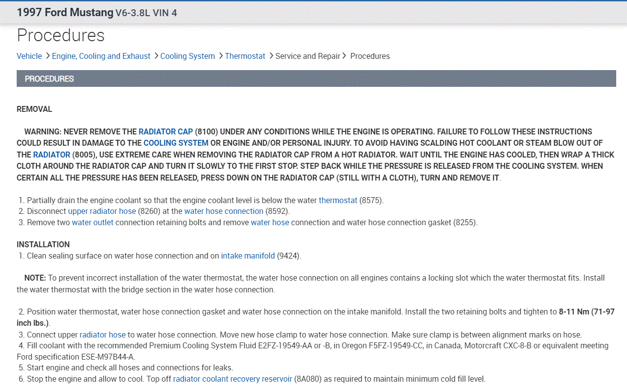

If you haven't, that is where I would start. Here is a link that explains how in general it is done:
If you look below, I attached the directions and a pic of the location specific to your vehicle.
Let me know if this is something you have already done.

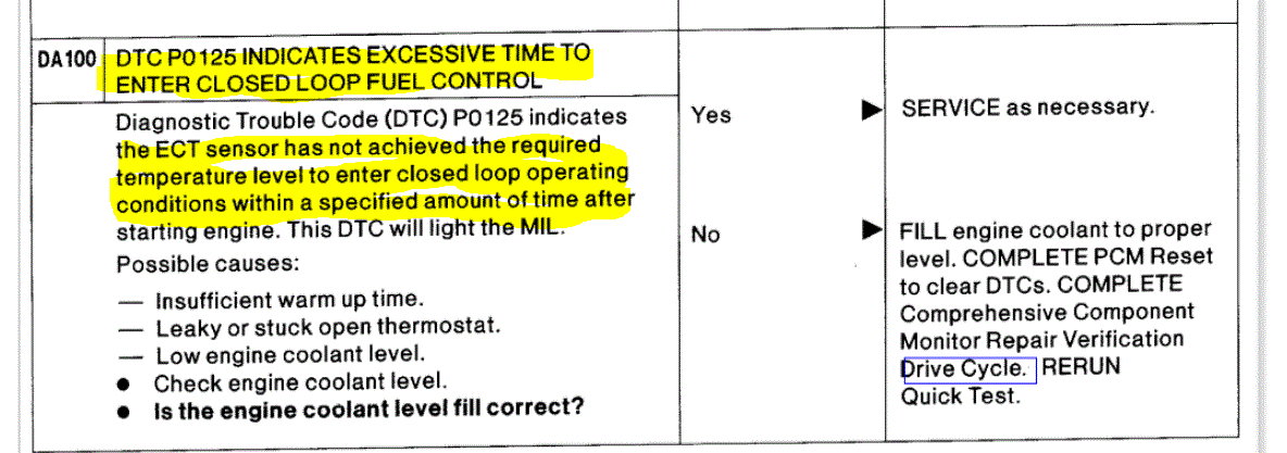

Okay. So, I ran a scanner on it and got P0125. Everything I read points to the ECT or thermostat or coolant level (this is okay). I noticed one more issue today. When I turned my heat to max, there is nothing coming out of the vents. So now what? Thermostat?

As far as the thermostat goes, I never recommend that unless it's an emergency. If the engine doesn't warm up fast enough, it will set an emissions code. On the other hand, removal of the thermostat opens the coolant flow completely which, believe it or not, causes it to overheat because the coolant moves through the radiator too fast.
Interestingly, I looked up the code you provided after writing the above info. The code is exactly what I described. The engine isn't warming up within a predetermined amount of time. Take a look at pic 1 below.
I would start with replacing the thermostat, which can be stuck open. Take a look through this link and let me know if you are comfortable performing it.
Note: The code is emissions-related because the vehicle stays in what is called an open-loop. This will cause the PCM to use a predetermined setting to run the engine which likely will burn more fuel.

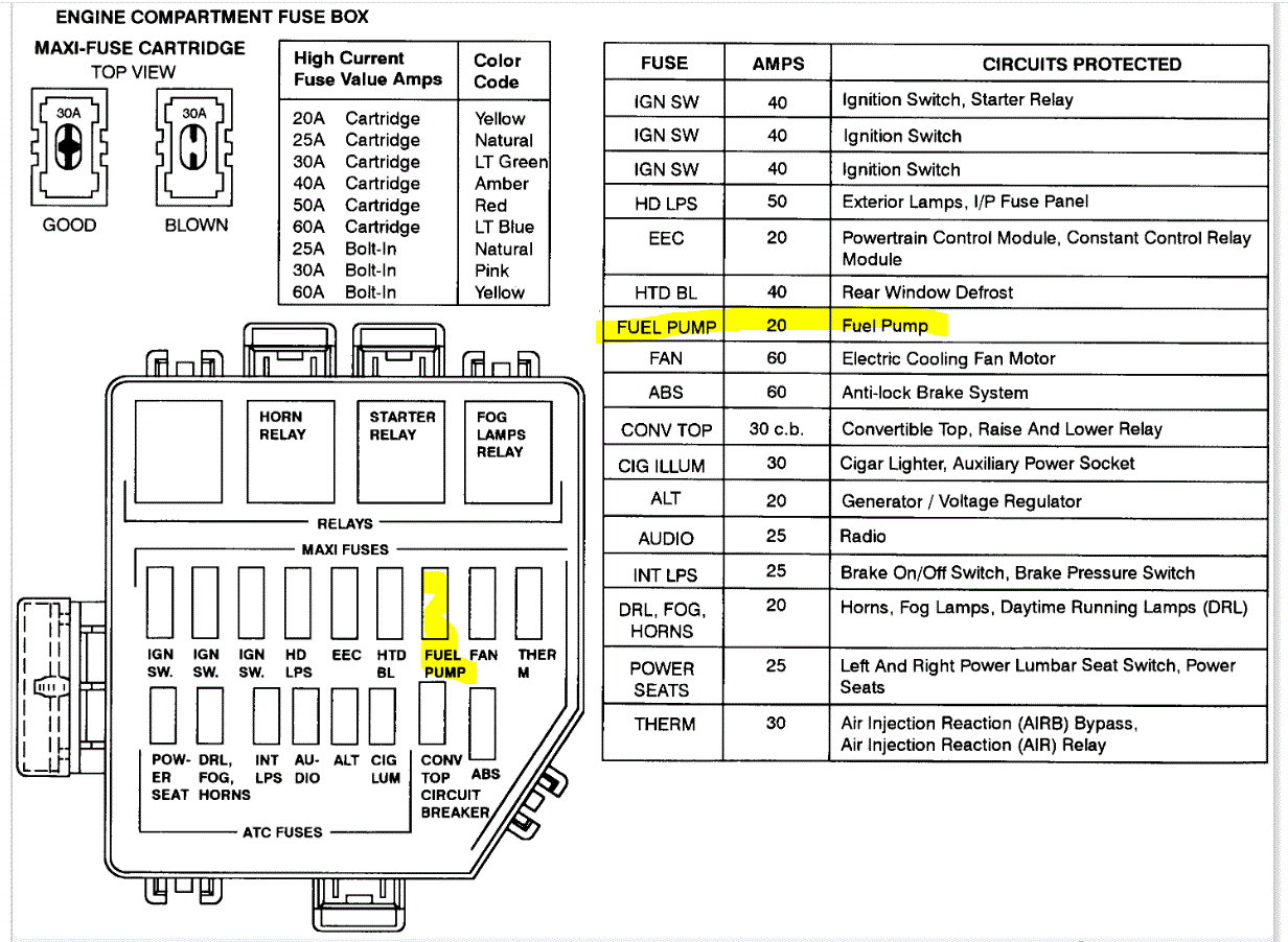

Okay, so, I did fix the problem. Turns out I had a coolant leak which caused the thermostat to stay open. However, now I have a new issue. Upon moving it, it just shut off. Checked the fuses and one was blown so replaced it, but it continues to blow the fuse when I try starting it. I think my fuel pump runs on it. I don’t have the right diagram for my fuse panel. The guy I bought it from gave me a 1996 owner’s manual and my mechanic told me what I have isn’t right. Could you start with providing the correct diagram for mine. 1997 Mustang V6 3.8L. Then I'm going to help in trying to figure out where I have a short and how to fix it. It is blowing the fuses on the same blade of each fuse I try.

The fuel pump fuse is in the under-hood fuse box. I attached a pic of the fuse box below. However, I have a favor to ask. We try to keep the threads specific to one topic, so they are more helpful to others. Would you consider starting a new post with the electrical problem? All you need to do is copy and paste your new question to the new thread. Here is the link to start a new question:
I hope you understand. When you start the new thread, let me know if the fuel pump fuse is correct so I can start going through wiring schematics.
See pic below.
