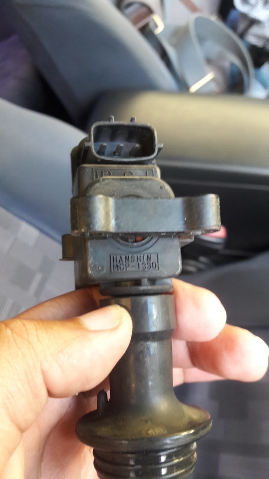

Well, we tested the coils after the car warmed up and started working bad like a WRX and unplugged and re-plugged all coils one on one. Coil three removed and nothing happened while the five other coils removed and the car worked even worse. So my friend who owns an r33 as well put his coil in mine and bam. Worked good as new.
So TLDR: One coil is completely dead and I am going to have to find an OEM coil for now and maybe in the future change all six for a better pack.
Saturday when I am free I am going to drive around and see if it will happen again. If not then the faulty coil would be the only issue I hope!

Yep, that will do it. I would do like you say and replace all of the coils. If one went out the rest are right behind it.
