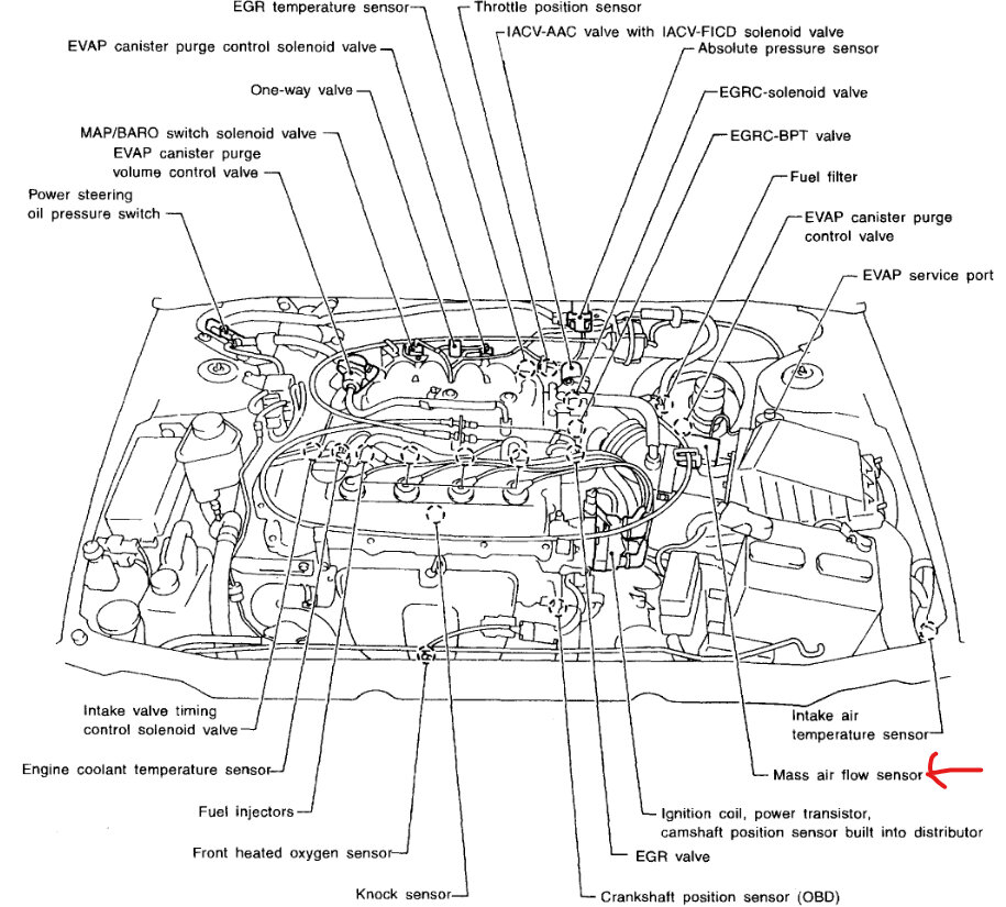

There is an internal ignition coil that sounds like it is going bad, but I would replace the ignition distributor with 140k on it. Also, I would swap out the MAF sensor as well.

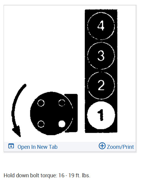

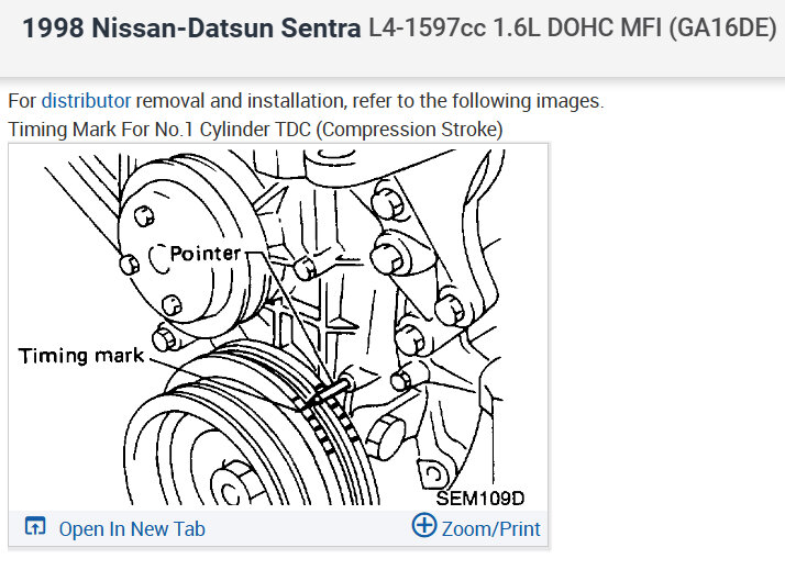

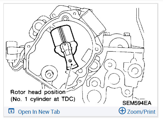

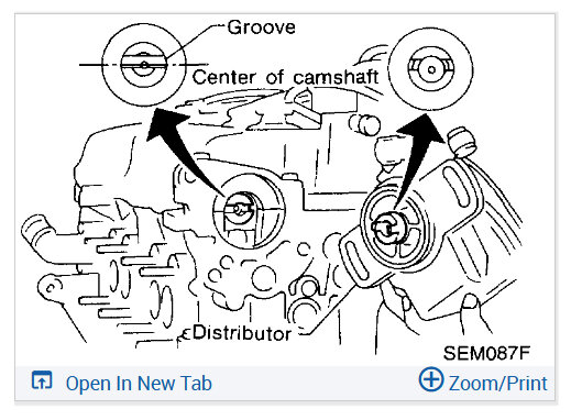

Here is how to change out the ignition distributor and set the timing, I would also make sure the spark plug gap is correct and that you have the correct spark plugs installed.
Spark plug ID
Standard .................... BKR5E-11
Hot .................... BKR4E-11
Cold .................... BKR6E-11 BKR7E-11
This guide may help as well.
https://www.2carpros.com/articles/repair-lean-mixture-codes-p0171-or-p0174-on-some-manufacturers
Ignition Timing - Base 8 +/- 2 Deg. BTDC
