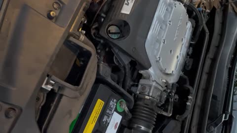

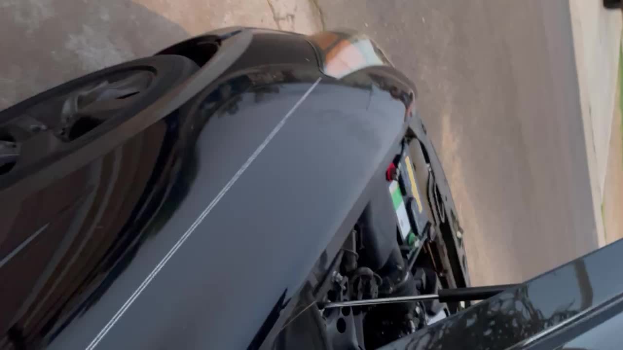

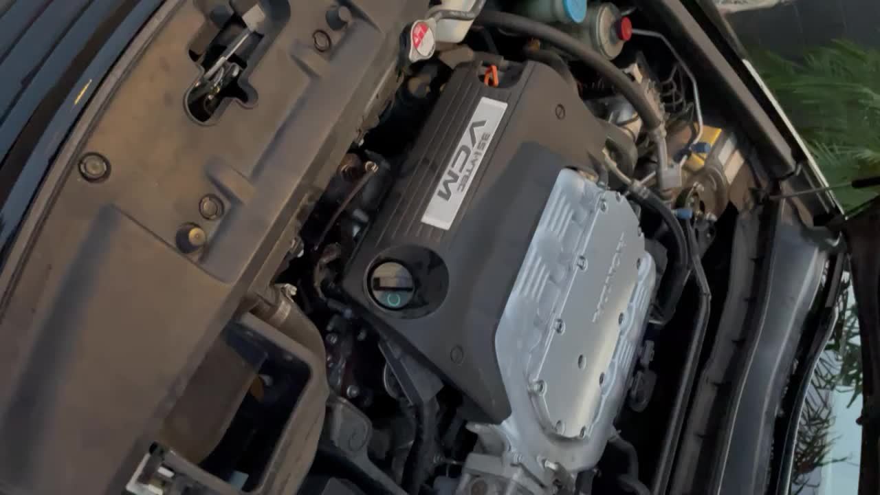

Hello all once again, back with another minor issue. About a month ago, I started noticing this whistling/whining noise coming from my engine. The noise enhances when I hit the gas pedal and there is also a whining type of noise when the engine is idle that I recently realized. I have attached two videos with the engine idle and another while I hit the gas.

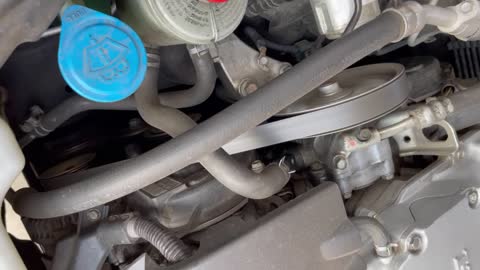

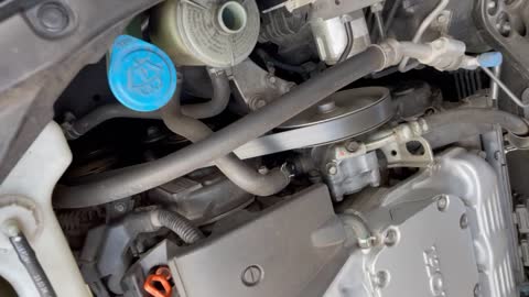

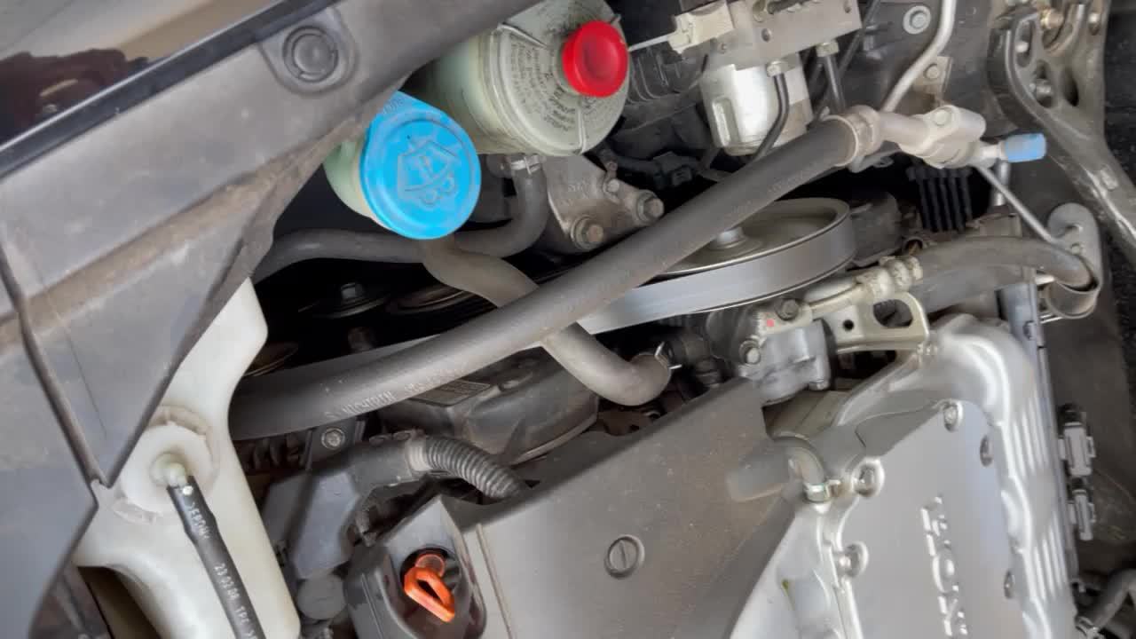

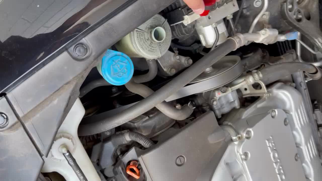

Back with an update: I checked the fluid level for the power steering level and it was indeed lower than it should be, as you can see in the video attached. This is also the engine running with the A/C off, and these two videos are with the power steering fluid low and then after I filled it up. I realize the noise is coming from the timing belt and pulley area.

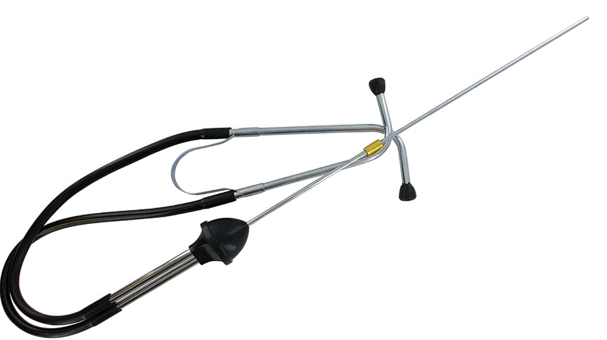

The alternator could be making that noise. Do me a favor. Here is a link that shows how to test an alternator to make sure it's charging. Try this and let me know the results. All you need is a multimeter or voltmeter.
Are you able to tell if the sound seems to be coming from the alternator? It's hard for me to tell. It sounds loud near the PS pump, but I can't be sure that is where it is coming from.
If you can't tell, you can get an automotive stethoscope and play doctor. LOL Basically, you place the tool on the components you suspect are making the noise to confirm. See pic 1 below. You can get these for under $10.00.
They are really cheap.
See pic below.

The noise was definitely coming from the alternator area, seems to be below the power steering pump.

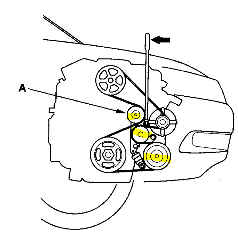

It could be the bearing in the alternator or other component. You may want to remove the drive belt and check each belt-driven accessory for play in a bearing or noise. Looking at the belt routing diagram (pic below) I see a belt tensioner, A/C compressor, and an idler pulley below and beside the alternator.
When you get back, let me know what you find. I would likely use a stethoscope.
Listening to your video, I have a feeling it's coming from the alternator, but listening to a recording could be throwing me off.
If you have a chance, let me know what you find.
