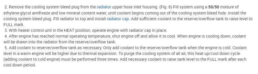

The bearing blew on my water pump and overheated. Got it towed to my house. Bought replacement pump installed and the truck is still over heading. I let the truck idle and get to temperature to allow truck to burp/bleed cooling system. And it is still overheating and making an odd bottom end sound. Kind of sounds like shaking a spray paint can.

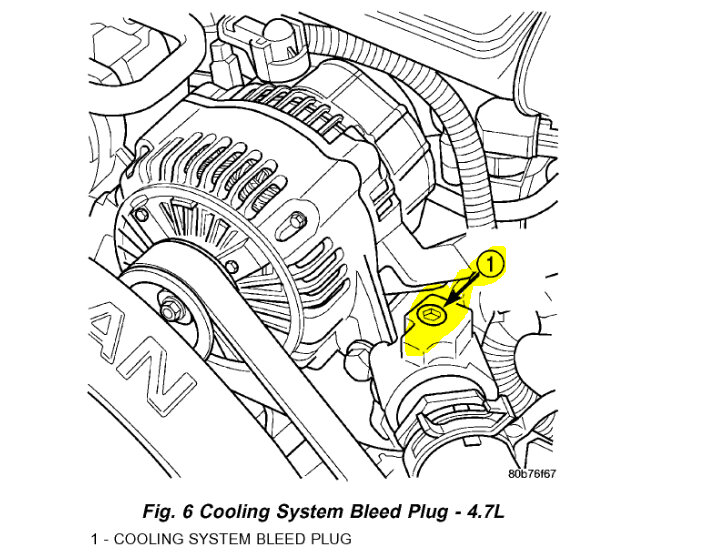

2. Proper way to burp/bleed system?

As far as filling the cooling system, there is a bleeder that gets removed to allow air to escape while filling. Once coolant comes from the bleeder, it is reinstalled and the radiator is topped off. See pics below.
