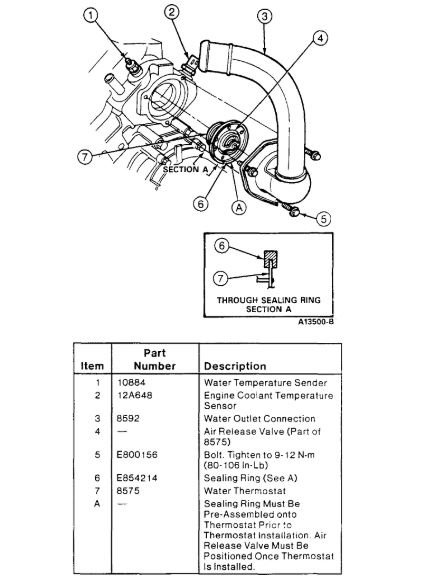

The needle is pointing to "C" at first, then as the engine heats up, the needle only rises to the beginning of the normal range.
I replaced the radiator and fan. The fan blows immediately after engine turn on. Could the fan be keeping the temperature sensor cool so that the sensor negative resistance coefficient feature is not allowing the temperature gauge to rise into the middle range? If I jumper the sensor cap to ground, then the gauge goes all the way over to hot.

This sounds like the thermostat is stuck open and not closing.
I would replace the thermostat.
REMOVAL
CAUTION: Do not pry on water thermostat to remove.
1. Drain the cooling system so that the coolant level is below the water thermostat.
2. Remove the coolant outlet housing retaining bolts. Pull the elbow away from the intake manifold sufficiently to provide access to the water thermostat. Remove the water thermostat and gasket.
INSTALLATION
WARNING: Do not stand in line with or near radiator fan blade when engine is running.
WARNING: To prevent incorrect installation of the water thermostat, the water outlet connection casting contains a locking recess into which the water thermostat is turned and locked. Install the water thermostat with the bridge section in the outlet casting. Turn the water thermostat clockwise to lock it in position on the flats cast into the water outlet connection.
1. Clean the coolant water outlet connection. Coat a new gasket with Perfect Seal Sealing Compound B5A-19554-A (ESR-M18PZ-A) or equivalent. Position the gasket on the intake manifold opening.
NOTE: It is critical that the correct water thermostat installation alignment be made to provide coolant flow to heater. Insert and rotate water thermostat to the left or right until it stops in the water outlet connection housing, then visually check for full width of heater outlet tube opening to be visible within the thermostat port in assembly. This port alignment at assembly is required to provide maximum coolant flow to the heater.
ImageOpen In New TabZoom/Print
2. Position the coolant water outlet connection against the intake manifold. Install and tighten the retaining bolts to 9-12 Nm (80-106 in lb).
3. Fill the cooling system with the recommended Premium Cooling System Fluid E2FZ-19549-AA (ESE-M97B44-A) or equivalent and water mixture. Check for leaks and proper coolant level after the engine has reached operating temperature.
NOTE: A coolant mixture of 50 percent coolant concentrate and 50 percent water is recommended to maintain best overall performance. To avoid damaging the radiator, the coolant concentrate should not exceed 60 percent.

I did already replace the thermostat with a failsafe thermostat from AutoZone, but same low temperature gauge reading.

I had the exact same problem with my 2003 Explorer (except I have a 4.6l). The problem was the temperature sender unit. I kept getting codes for coolant temperature running cold, and also, sometimes it would peg the meter like it was overheated. At first I replaced the thermostat. I still had trouble with the gauge so I replaced the temperature sender and that solved the problem.
