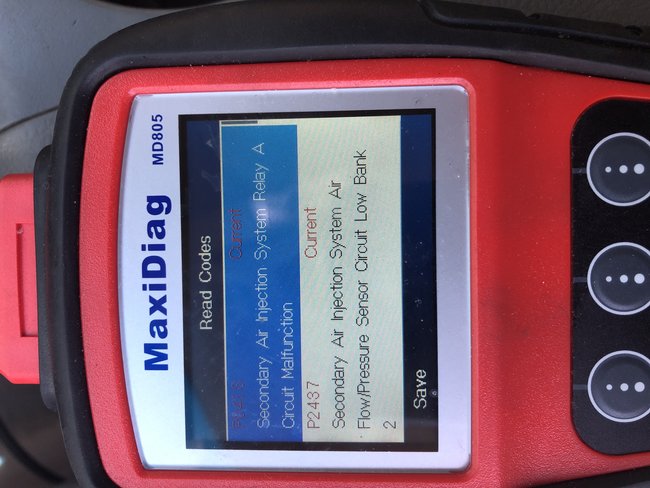

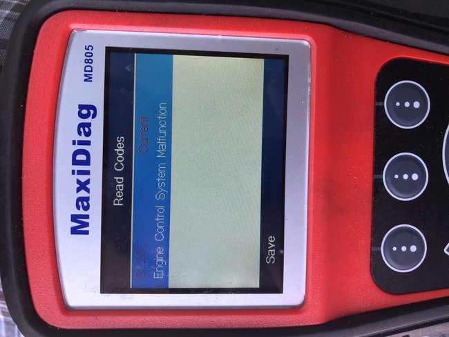

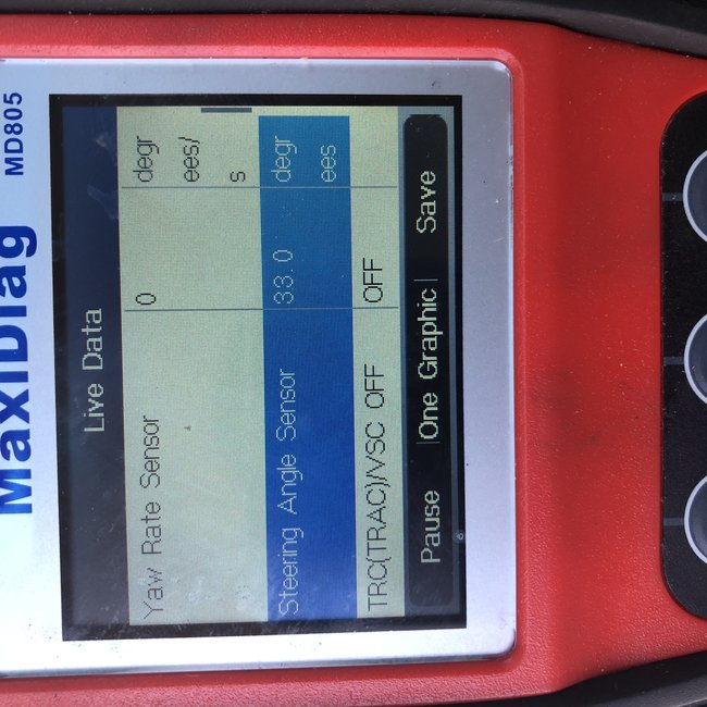

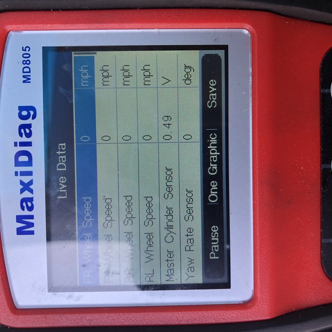

4.7L, , engine and transmission still great, all these lights were on, but the VSC flashes. If i check the engine codes i get these 2 for the secondary air pump which is common on these and vehicles. You delete them and come back immediately. VSC/ABS codes only c1201 which am sure you are aware are common to Lexus and Toyota. I delete them all ad engine codes and drive for half a mile and all lights stay if then i get yoke and park it and they come back. Front brakes were shimming so bad so replaced rotors and brakes. Tear are also bad on metal so am replacing them as well. All ABS sensors are reading okay when driving. Am trying to figure out why these lights keep coming on with no specific codes. Even the secondary air codes should go away and engine light stay off for a while but it doesn't. Where is the secondary pump, maybe someone unplugged a wire or a hose or there is a tear or an issue in the harness? Any suggestions appreciated.

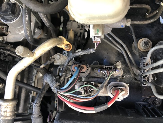

Checked the 7.5amp fuse for the ECU and is okay. Removed the black connector which has to do with the p0418 and it had water in it and one of the pins was corroded, not sure how, cleaned it and reset the codes after disconnecting the battery same thing.
This is the black connector with blue wire coming out:
