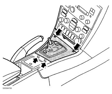

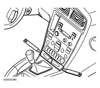

I need to remove the center console in order to connect loose transmission linkage connection. I found two screws in the bottom of the console tray and two plastic screws on the sides of the console. I was told there are two more screws located behind the pen holder. Where is the pen holder? How do I get the last two screws out?

https://images.2carpros.com/forum/automotive_pictures/108325_pen_holder_1.jpg

https://images.2carpros.com/forum/automotive_pictures/108325_pen_golder_2_1.jpg
