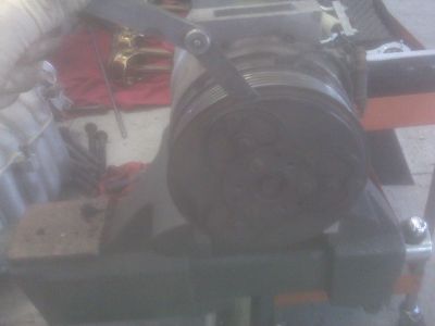

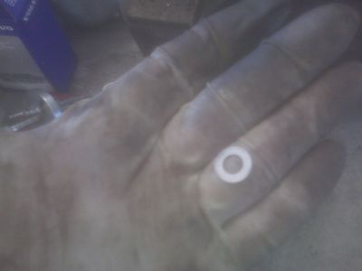

Suggest that they check the gap clearance on the compressor clutch. The spec calls for 0.3mm to 0.5mm Get a feeler gage greater then 0.5mm. If it goes in then You can try to remove some the shims to adjust the gap on the compressor. If you can not get it down to spec then the clutch will need to be replaced. I removed a shim from my clutch for the same problem
https://images.2carpros.com/forum/automotive_pictures/337695_IMG00157_1.jpg
https://images.2carpros.com/forum/automotive_pictures/337695_IMG00156_1.jpg
I measured the gap and was lucky to get it down to 0.3mm. My S80 now blows cold again. What happens when the clearance is too wide, when the metal gets hot it expands and makes the clearance even wider. So as the compressor clutch cycles on and off when it goes off eventually the clearance is too wide that the magnet can not pull the clutch back in. Keep me posted please. What dealership is your car at?

If they just left the vehicle idling for hours then it will not cut off. They actually will need to drive it to make it quit. Have you asked them to check the compressor clutch clearance?
