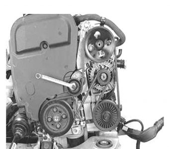

Would you have the serpentine routing diagrahm for a 2002 Volvo S80 T6

This is what i have
hope that will help
let me know

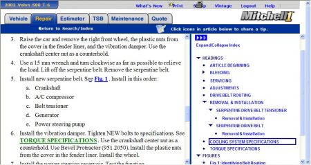

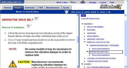

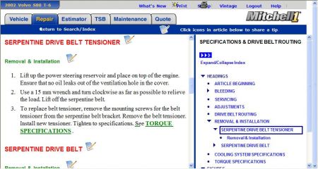

Unable to upload the belt routing BMR took care of that but see below
