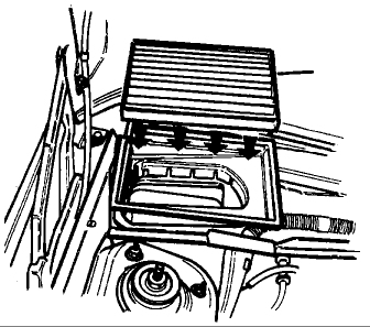

Where is the cabin air filter in the volvo s70

The pollen filter is located under the cowl upper section on the passenger side of the engine compartment. To accesss it just remove the first 2 screws wich are 25 torques screws. Pry cowl up gently and should be able to get your hand in there to remove and install.
