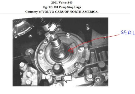

MHPAUTOS
  • CAR REPAIR CONTRIBUTOR
  • 31,937 POSTS
Hi there, The oil pump is driven by the timing belt (see pic of pump & seal indicated, also i think the second seal they are referring to is the front crank shaft seal, now if this is the case, this part of the job will take about 5 hrs on to of the 7 or so to do the other work so this would bring the labour down to around $140.00 PH local rates, still high i feel and i doubt that it all could be done in 1 day, what did they quote on parts and are they replacing the timing belt?
https://images.2carpros.com/forum/automotive_pictures/61395_pump_4.jpg
Mark
