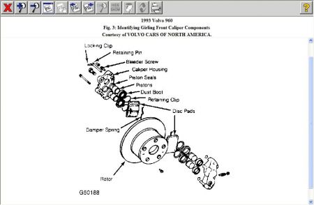

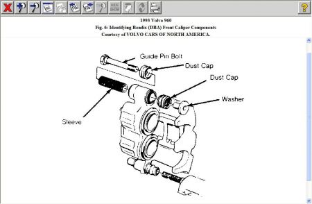

How can I tell what kind of calipers I have on my car? I was told ther are three differnt kinds. Please advise.

Hi reiproms,
Each has a different design and you would have to visually inspect them to know. Note the difference and the third one is ATE which I do not have any diagrams to show you.
https://www.2carpros.com/forum/automotive_pictures/192750_FrtBrake96VolvoBendix_1.jpg
https://www.2carpros.com/forum/automotive_pictures/192750_FrtBrake96VolvoGirling_1.jpg
