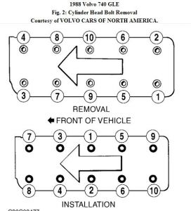

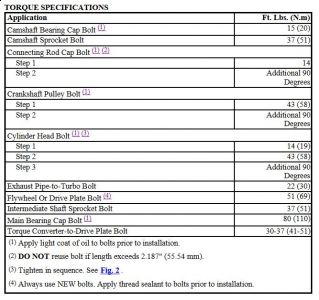

what is the torque spicification on the cylinder head bolts, the main bearing caps and the conrod bearings

Hi carlspence,
Here are the specs.
