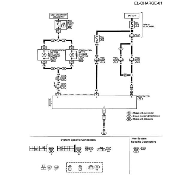

Changed alternator. Took car to AutoZone and put on tester. It said bad voltage regulator. So I changed it again. Same thing. Took alternator off and it tested fine so I put it back on. Again it says bad voltage regulator. Checked fuses, all okay. Checked wiring with volt meter and light tester, everything had power where it is supposed to. Alternator is charging battery.
My question is, what are the dangers of running car like this? I do not know what else to do.

The voltage with car running and while revving it up to 2,000 rpm's is 12.5. Same as when it is not running.
I changed alternator cause battery went dead. After I changed it, the battery charged back up. The bearings in the old alternator pulley went bad.
Thursday, August 30th, 2018 AT 6:13 AM
The alternator is not working. It should be 14 to 14.5 volts.
Diagram attached. Check for voltages and the fuses for power in the diagram.

Fuses all good.
Took new alternator off and had tested at AutoZone. It is good.
Cannot really tell anything from diagram you sent. When I enlarge, it gets fuzzy.
When I put alternator back on and test charging system at two different auto stores, it says bad voltage regulator. They both say my battery is good.
Thursday, August 30th, 2018 AT 8:11 AM
The voltage regulator is inside the alternator.
You need to return it and get another brand of the alternator. If all the wiring is good and you have correct voltages to the alternator, then the only thing left is the alternator.

Put the new alternator (not a refurbished one) on this morning.
Got my voltage tester on it. When car is running and I touch the posts on battery, it reads 12.7. Same as when it is not running. But when running and I touch the hot wire on back of alternator and the negative post on battery, it reads 14.7. And touching same when it is not running, it reads 12.7
Does this mean the voltage regulator is working?
Thanks
Sunday, September 2nd, 2018 AT 8:52 AM
If you have 14.7 coming out of the back, the alternator is working.
You have an issue with the wire from the battery to the alternator.
