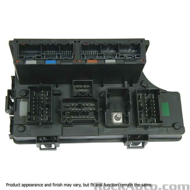

That's the tipim fuse box under the hood I have seen them go bad and cause all kinds of problems. It's a fuse box with a computer. They can be intermittent and hard to diagnose. Try clearing the codes then while it's running push on the relays and different parts of the tipim fuse box and see if the codes come back.

Today I took off the tipm from his mounting bracket and wiggled the connectors, a p0882 code shows up. The problem was the yellow with brown strip wire coming from the pcm had bad connection at the tipm connector. I think p0882 code is fixed I cleared the codes and I did not see code p0562 yet.

What happens is the large wires run a lot of current thru them wwith a lot of heat. So they open the terminal connection over time. Glad to hear you got it fixed that's what we're here for.
