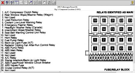

please anybody know where is located the starting relay in 91 passat my car dont start I replaced the starter and ignition switch and still no starting thanks for any help

Starter Interlock/Back-Up Light Relay In fuse/relay block. See below
https://images.2carpros.com/forum/automotive_pictures/12900_volks_2.jpg
